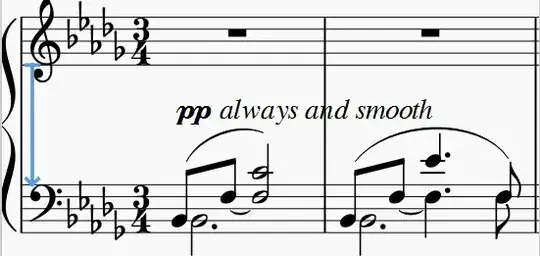

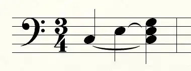

My answer is ultimately similar to Bob Broadley's, but has one difference that can make for much more readable scores in slightly more complex situations. This is the standard notation for broken held chords like the one you describe, as recommended by Kurt Stone and Gardner Read:
The difference here is that you don't rewrite any of the held notes until the chord is complete. For your specific relatively simple case, I don't think it's much better than Bob's. However, in an even slightly more complex situation:
the readability can be greatly enhanced. One of the things I like most about this notation is that it's fairly clear, even when the pianist hasn't seen it before. I use this notation in a lot of my piano music, and most pianists don't even bat an eye because they've seen it before. The few that haven't still immediately guess the meaning. The notation you describe in your question will eventually be figured out, but looks so much more complicated than the actual method of performance that it can be annoying. Same thing, albeit to a lesser extent, if you rewrite each tied note with each new note entrance. In more complex situations it can become difficult on first glance to ascertain which notes are new and which are being held-over.

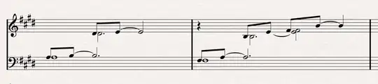

Sometimes it will be obvious to a performer that you need to sustain notes that together outline one particular harmony (a single triad, for instance). If you want to make this explicit, though, you could use notation such as the following:
I'm not sure that this is used that much in piano music, probably because the pedal will produce the required effect (although I understand why you don't want to ask for pedal use here). However, it is a common way to show exact note durations in arpeggiated guitar music.
Also, if you want to make it clear that no pedal should be used, you could write senza ped., in addition to the notation above.

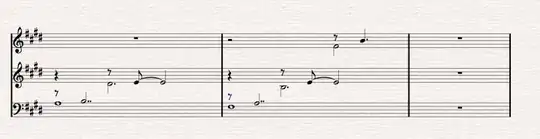

The main way I've seen this done is to use multiple voices to show the durations. Here is a short excerpt from a piece I was copying into my notation program:
trlkly
  • 753
  • A pianist seeing that notation, particularly one with smaller hands, may well see the pedal as an acceptable solution. Senza Ped. will make it clear. When there is a melody above that would be blurred by pedaling, a good pianist SHOULD choose a technique that combines sustain with clarity. But remember that higher notes have less sustain anyway, even with pedal. The performer may not need meticulous instructions quite as much as you think. Pianos are more subtle than sequencers and samples! – Laurence May 27 '16 at 14:56

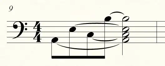

You can use a Tie to sustain notes in this manner.
There is more here: https://en.wikipedia.org/wiki/Tie_(music)

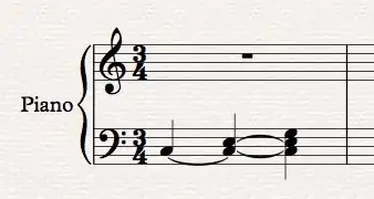

It is probably best that you write what you want above the first measure then write (sim.) if it continues in the other measures as shown below.
If there isn't a simple way to notate something you can use a few words to describe it.

    Neither the note-heads nor your words indicate correctly how long the Cs and Es are to be held. – Rosie F Oct 12 '19 at 16:38
