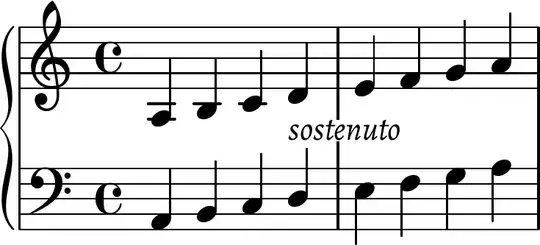

ETA: My overarching goal is to correctly white out the parts of bar lines that would otherwise intersect with expressive marks, like so:
a score with "sostenuto" crossing a barline
The full code can be found here at LilyBin.

This is a late answer, but are you familiar with the /whiteout command? It's a pre-defined tool that explicitly handles your "overarching" goal of barlines interfering with expressive marks. Something like d^\markup { \italic \whiteout { sostenuto } } will do the trick:
Full code here at LilyBin.
