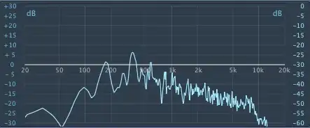

4) I have been challenged before when I have said that the higher the overtone is, the less significant it is, because the overtones become less audible as they get higher and higher. Is it true or not true that overtones become less audible as they get higher?
It depends. You can synthesize a sound with any harmonic ratio you can think of. But yes, less exotic sounds will have that tendency, the higher the harmonic the lower the amplitude It's not a constant, this tendency is commonly broken: some higher harmonics might have a higher amplitude than some lower harmonics. Some lower harmonics might not even be present, as some instruments cancel or attenuate specific harmonics.
It's a tendency, not a constant, there are many exceptions. That's maybe why you were challenged about it.
Alto sax:
Alto Sax
Nylon guitar:
Nylon guitar
Trumpet:
Trumpet
Snare drum:
Snare drum
If so, doesn't this mean the lower overtones are of more importance?
The less amplitude an harmonic has, the less it adds to the sound. So, higher amplitude harmonics add more to the sound, they are "more important". As lower frequency harmonics tend to have more amplitude, there will also be a tendency of lower frequency harmonics being "more important", but it's not necessarily the case, as lower frequency harmonics not always have higher amplitude than other higher frequency harmonics.
It would be more accurate to say "higher amplitude harmonics are more important".
Has there been any research done on amplitude of various overtones (say, given a certain instrument such as guitar or piano) and the point at which that amplitude is so low that humans can't hear it?
Interesting question. Don't know of any study in particular, but you can do it yourself.
Use a very steep high pass (low cut) filter and increase the cutoff frequency until you can't perceive a sound. That's where you stopped hearing the harmonic series at that specific amplitude. Now check the cutoff frequency and the fundamental of the sound you filtered. Divide the cutoff frequency by the fundamental and that's roughly how many harmonics you were able to hear.
That doesn't deal with masking and other dynamics, though. Maybe another experiment you can make is the opposite. Use a very steep low pass (high cut) and decrease the cutoff frequency until you perceive that the sound is changing. If you don't perceive a change, it means that those harmonics (if any) aren't adding something to the sound (at least to your ears). When you perceive the smallest change, do the same: divide the cutoff frequency by the fundamental and that's roughly how many harmonics were "important" enough for you to hear a change.
You can then check the amplitude of those harmonics around the cutoff frequency in relation with the fundamental with an harmonic analyzer.
I wonder if the two experiments yield similar results.
