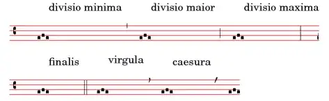

  • Maybe look at http://lilypond.org/doc/v2.18/Documentation/notation/typesetting-gregorian-chant#divisiones – User8773 May 05 '14 at 05:47

Maybe the command \divisioMinima shown for Gregorian chant notation would be a hack for you.
I have not checked, if it can be followed by a bar.
