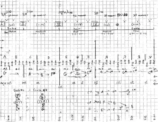

I have often used graph paper to create a left-to-right timeline where each cube of the graph paper represents a unit of time (say 5 seconds, or 15 seconds). I then "draw" the form, sometimes getting carried away with colored pencils and such. I then try to compose the music in-line with the formal diagram. This doesn't always work and sometimes leads to a train wreck. But sometimes the stars align and it leads to good music. Often the piece that ensues ends up bearing little resemblance to the original formal diagram.
Here is an example of a formal diagram and the resulting piece. Although, the final piece bears little resemblance to the original diagram, I believe the diagram was an important part of the creative process.
Lastly, composing is different for everybody, so if sketching forms doesn't work for you, don't do it!
Escape Sequence Recording on Spotify
Escape Sequence Formal Diagram
