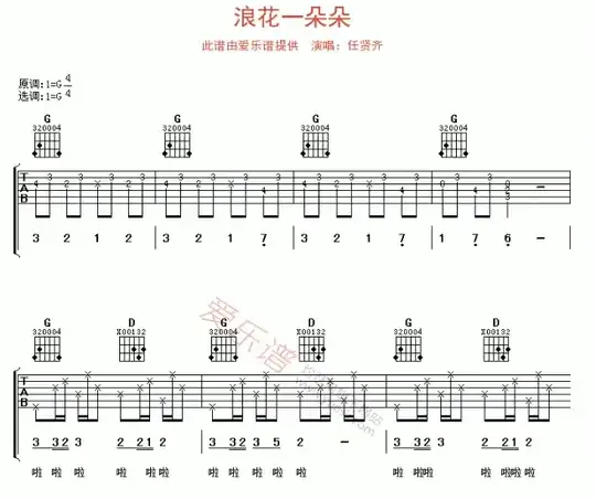

A Chinese friend of mine requested I learn her favourite guitar tune:
http://www.yuesir.com/ipu/271.html
However, I have big trouble undestanding the convention used is this tab. Could someone explain, or provide a reference, on what the different numbers, crosses, lines, dots and arrows mean?
First two staves from linked page.

    Can the image be copied here or is there a copyright issue? – luser droog Apr 18 '14 at 07:09
    I've gone ahead an added a snip from the first page. IANAL, but I think it's brief enough to be considered "fair use" under US copyright, although there may not be such an exception under Chinese law. Here's hoping no trouble arises. ... – luser droog Apr 19 '14 at 04:59
  • Nice one! Hopefully my answer will make a bit more sense... – Bob Broadley Apr 19 '14 at 08:21
I've seen some sheet music like this before, brought to me by guitar pupils from Hong Kong. The cross-headed notes are quite easy to get your head around; they simply show you which strings to pick while using the chords above the TAB stave, and the rhythm of these arpeggiated notes. The arrows show how many strings to strum for the chords above the TAB stave.
As for the numbers below the guitar TAB, these show you the notes of the vocal melody (or instrumental melody in the intro). But, instead of using actual pitch names or notes, these numbers represent the degrees of the scale of the key you're in. So, in G Major, a 3 represents a B natural, a 2 represents an A natural, and so on. It's a bit like the movable do system. This is why you have the marking 1=G at the beginning.
ADDITIONAL INFO: obviously, this Solfege method of showing the melody line with numbers, doesn't give any information about which octave notes are in. To get round this, dots are used: a dot above a number shows that a note is in a higher octave; no dot indicates a note in a middle octave; a dot below a note shows that a note is in a lower octave. Although this is not quite as accurate as conventional notation, it works pretty well; it is unlikely that a vocal melody would have a range of more than 3 octaves (unless you're notating some Kate Bush, perhaps...)
Quavers and semi-quaver rhythms are shown with the appropriate beam lines under the melody numbers. Rests are indicated by a dash.
It's a really different system to the one I'm used to!

  • Yes, it appears that's what's happening, as each chord shape sounds in turn when the appropriate strings are played. Why are there numbers instead of x in the top line, and why would 'o' be written at the end of that line? – Tim Apr 17 '14 at 06:36
  • That's just normal TAB. – Bob Broadley Apr 17 '14 at 07:31
    Bob - first 3 bars - 5th note is 'x'. In tab this usually means a dead note. In the 4th bar, there are similar notes, but shown with 'o'. I'm trying to work out if it's the same thing, shown differently, or what. – Tim Apr 17 '14 at 10:22
  • Well spotted. I reckon both mean open strings, but the notation isn't consistent. – Bob Broadley Apr 17 '14 at 11:03
  • Yep, I'm pretty certain of this; this would mean the first x open string continues to follow the melody (like notes 1 and 3). – Bob Broadley Apr 17 '14 at 11:08
  • As I though, but why use two different symbols for the same thing ? – Tim Apr 17 '14 at 12:05
  • Tim - I can't read Chinese, so can't read anything on the site, but I would guess this is similar to TAB sites in the US and Europe, and this is probably not a published TAB, but is instead a "fan-work". For this reason, I would say the use of two different symbols for open strings is just an inconsistency on the part of the person who created the TAB. Besides, I'm always finding mistakes in published music too, and Chinese TAB books (this music may be copied from one) seem to have quite a few errors. – Bob Broadley Apr 17 '14 at 12:12
