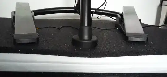

I found that a "mattress sandwich" does the job very well. High-density rubber helps to block sound and low-density fibre helps to absorb sound. Without this the drum pads and pedals would sound like somebody doing DIY through the floorboards to the room below. But with this it just sounds like pitter-patter of rain drops. :)
My "mattress sandwich" is made from: 1 x Cot Mattress (Eco Fibre, 100x70x7cm); £20 at amazon. 2 x Protective Anti-Vibration Rubber Mat (100x60x2cm); £30 at floormats. Total cost: £80. :)
In contrast, Roland's set of noise eaters and mats would cost over £300.
mattress sandwich
