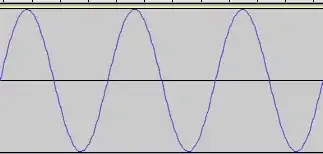

Using software, we can "see" these overtones, and the waveform of the sound.
This is the waveform of a sine wave:
sine wave

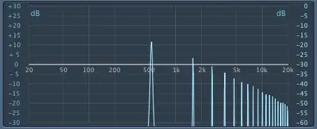

Now let's see the waveform of a square wave:
square wave
And the overtones of the square wave:
square wave overtones
The square wave has many more overtones! It sounds "dirtier".

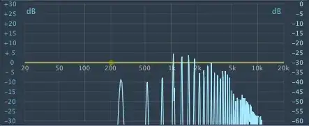

This difference in overtones can be found in acoustic instruments too. Let's look at the overtones of 3 instruments: a clarinet, a piano, and a trumpet, all played in C 261.62Hz.
Clarinet:
Clarinet
Piano:
Piano
Trumpet:
Trumpet
We can see that the trumpet is much more rich in overtone content than the clarinet and the piano; the trumpet is "dirtier".
