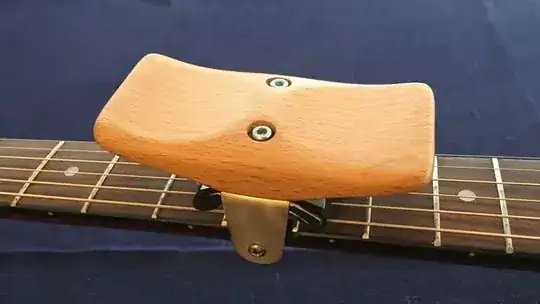

I wanted to add this alternative invented by a music teacher in Sweden to help students with disabilities be able to play the guitar.
Closeup of klaffguitar
Depending on the way the lever is pressed (left/right/upright) three different chords can be played. These are custom fitted by the inventor himself, and my father recently got one of these fitted to one of his guitars.
It is called a klaff-guitar which might be translated as a hinged guitar. The Swedish word klaff is a bit hard to directly translate, but is used for example to describe a heart valve or the hinged part of a drop leaf table.

    What a wonderful idea! Can the klaff be moved easily while playing or is it screwed into one specific fret and needs to be unscrewed if one wants to move it? – terdon Nov 09 '22 at 14:29
    @terdon It is screwed in place and it is not possible to move it. You can re-tune the open chord, the other two are fixed relative to it. – user1884905 Nov 09 '22 at 15:10
    Surely the next step would be to produce one which worked something like some of the capos - movable? – Tim Nov 10 '22 at 09:12
    This is an amazing invention! – Ernest Friedman-Hill Nov 11 '22 at 14:47
    I wonder if something like that could be enhanced by the use of an alternative tuning? If the device was mounted on rails, I think it would probably be possible to design a device that could play ten flavors of chord at each of the first seven fret positions: fifth-string-rooted major triad, minor triad, major seventh, minior seventh, and dominant seventh, and sixth-string rooted versions of those same chords. To select the root, push the device slightly toward the bass or treble side of the instrument, to select major or minor use the device either slightly above or slightly below a fret... – supercat Nov 11 '22 at 20:04
  • ...and to select between triads and seventh chords, press the device toward the firetboard gently or more firmly. – supercat Nov 11 '22 at 20:05
