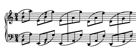

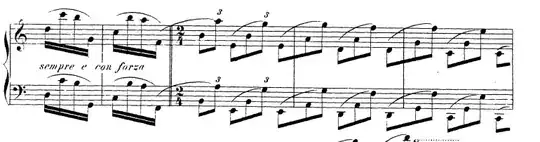

  1. Tuplets, beamed across the barline, but with notes aligning with the downbeat (Brahms, Variations on a theme of Paganini):
triplets beamed across the barline, from Brahms' variations This example aligns the tuplet '3' with the final note of the beams, so the bars are six triplet-quavers each, but beamed across the barline. This choice isn't universal; some publishers align the tuplet '3' with the middle note of the beams:
triplets beamed across the barline, from Brahms' variations, but with the tuplet 3 aligned with the beams

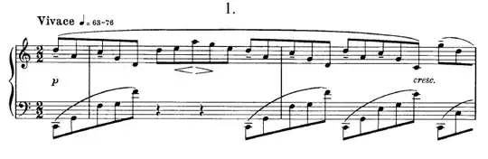

  1. Tuplets, beamed across the barline, with no clear indication of whether the notes are supposed to align with the downbeat or not (Scriabin, Prelude Op.11 No.1): an example of tuplets beamed across the barline, from Scriabin's prelude and also (same piece): another example of tuplets beamed across the barline, from Scriabin's prelude, with a metrically-unclear left hand rhythm The first bar starts with two (quintuplet?) quavers; the final bar isn't missing any duration to compensate. Exactly how the left-hand crotchets match up with the right-hand quintuplets is unclear.

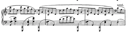

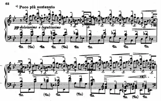

  2. Tuplets, beamed across the barline, with notes definitely not aligning with the downbeat (Godowsky, Studies on Chopin's Etudes, No. 19): an example of tuplets crossing the barline, from Godowsky Here the lower voice in the right hand is playing triplet quavers, offset by a non-triplet quaver; the tuplet clearly crosses the bar (and the middle triplet-quaver is correspondingly split into two tied triplet-semiquavers). (The final triplet, in the last bar, is three triplet-semiquavers, to compensate for the initial non-triplet-quaver rest in the first bar, and re-align the notes with the barline again.)
Whether you'd consider the first two examples to be "tuplets crossing the barline", I don't know - I think I would, but if you wanted to argue that the tuplets were within-bar and just beamed weirdly, I think that's also valid. I think the last example is fairly unarguable, though.

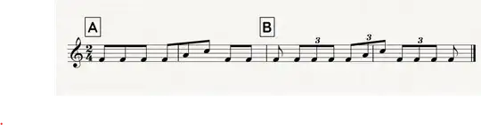

Tuplet groups across barlines (example B) are 'impossible' by the rules of traditional notation, but like irrational time signatures (4/7, 5/3 etc.) are becoming more common.
I used Sibelius to make the example, and had to cheat - the bars containing triplets are really one 4/4 bar with a graphic barline. Dorico is more amenable, though this description of how to do it includes a telling remark:

  • At B, the third bar, 1/2 + 3/3 + 2/3, that's more than 2 beats?!? Did I miss something? If it isn't metrical why use time signatures and barlines? – Michael Curtis Nov 08 '22 at 13:57
  • @MichaelCurtis - The duration of one triplet of eights is equal to two real eights: {3/8} = 2/8. If a triplet is crossing the bar line, one half of that triplet's duration belongs to the first measure, and the other half, to the next one. It's easy to see that one half of a triplet is one eighth: {3/8}/2 = (2/8)/2 = 1/8. Keeping this in mind, what we have in the third measure is: 1/8 + {3/8} + {3/8}/2 = 1/8 + 2/8 + 1/8 = 4/8 = 2/4, which is exactly what the time signature shows. – brilliant Nov 08 '22 at 14:35
    @brilliant. "...one half of that triplet's duration belongs to the first measure, and the other half, to the next one...." Yes. But this notation does not visually show that. It doesn't show 1/2 before the bar line and 1/2 after the bar line. It shows 2/3 before the bar line and 1/3 after the bar line. The actual values don't match the visual reading of the measured notation. Why force a bar line into that notation when it can be avoided with a meter change? That seems to be the point of the quotation. – Michael Curtis Nov 08 '22 at 17:06

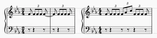

It seems worth considering whether it's better to fake the bar line placement or just change the time signature...
In the first instance you would logically need to draw the dot on the bar line, or draw it before the bar line to show it starts before the bar line, but then you end up with a note value that doesn't fit the actual duration... and it's hard to read.
The second instance just removes the bar line, avoids the note value/duration problem, and is actually readable, although I imagine it will get played incorrectly by a lot of people.

  • I think I follow but I'm not totally clear... are you using the tied eighth notes as a stand-in for the triplet that you don't want to write out? If that's the case, I think it would be better to write out the triplet, to demonstrate what it would look like. If that's not what you meant, then I don't understand the answer. – Edward Nov 11 '22 at 01:04
  • The triplet is written out in the second example, the one in 4/4 meter. In the 2/4 example, yes, the tied eighths show a full beat crossing the bar line. In the 4/4 example that same full beat duration become a triplet... _without any issue of splitting the triplet over a bar line. It isn't a question of not wanting to write out the triplet. The question is whether to write it out over a bar line if it can be avoided with a meter change. – Michael Curtis Nov 11 '22 at 22:11
  • I'm basically saying the OP is probably misguided to force a triplet over a bar line. Read the comment in Lawrence's answer: it is "...rarely...best practice..." It is not recommended. My answer is just stepping through the notation process to show how the conundrum is avoided. – Michael Curtis Nov 11 '22 at 22:17

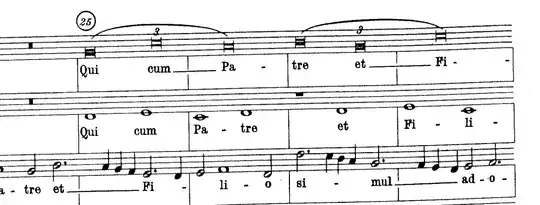

This is sort of a corollary of "can anything cross a barline?" and the answer differs for semi-modern notation (starting with late Baroque) and earlier music (Medieval through Renaissance to early Baroque). Those music forms don't have the usual strong beat relations of later music and their notation will not usually use ties for splitting notes across bar lines. Modern editions often put the bar lines only between systems, and the manuscripts may not even have contained them at all.
Here is an example from the Missa de Beata Virgine from Josquin des Prez: Missa de Beata Virgine
The soprano triplets clearly stretch over multiple measures (3 notes per 2 measures) and notating them with ties would really mess up the notation and character here.
