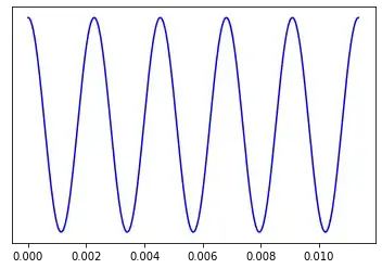

Here is a simplified illustration. In the following picture, the x-axis is time, and the y-axis is the extent of your guitar string up vs down after you pluck it (or the pressure of the air, high vs low at some point near your ear, or the extent of your eardrum, in vs out).
A4 listen:
The 0.01 on the x-axis is in seconds. That's right, remember that our string is going back and forth at 440Hz - that's 440 times per second! For reference, low-E on your guitar is E2 at about 82Hz. Pluck your low E string and see if you can count the number of times the string goes back and forth in one second. :)

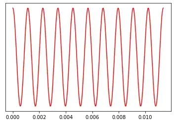

A5 is higher pitched, meaning that the string is vibrating faster: 880 times per second.
A5 listen:

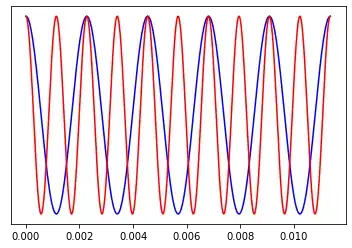

If we plot them together, we see that every other time our A5 string is at the top of its vibration, our A4 string is also at the top of its vibration! In other words, both A4 and A5 vibrate at 440Hz (but A5 also vibrates at 880Hz, and A4 does not). There's nothing particularly special about the top: if we plucked them at slightly different times, then perhaps our A4 string would be at the top every other time A5 is at the middle (different "phase"). It's happening so fast that we don't "hear" the phase, but we do hear the alignment. The important aspect here is the lining up "every other time". That is what musicians mean by calling both of these notes "A". The fact that its "every other time" and not "every time" is the difference between A4 and A5.
A4 and A5:
