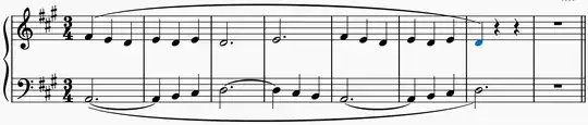

Béla Bartok's Mikrokosmos - Vol. I is a book of short and simple, yet quirky piano pieces. Piece No. 24. Pastorale is shown below.
A full bar rest (for both hands) ends the piece. This is something I haven't seen before for a solo performer, and I can't make much sense of it.
Béla Bartok's Mikrokosmos - 24. Pastorale, with annotations
Analysing the form/structure:
The piece is in ternary (ABA) form, with each section being 8 (or perhaps 7+1) measures long.
The phrasing slurs generally conform to these sections, but there are anacrusis-type-things (marked in brown) that start the phrases of the second and third section "early".
How are these "extra notes" functioning musically?
I understand that music doesn't have to follow any rules, and usually sounds more interesting when it occasionally doesn't; and this piece does sound "good". But as far as I can tell, it sounds just as good without the final measure.
If the phrasing is not following an 8-measure-per-section structure strictly, then why is the last bar not just omitted?
What is the musical function of the full bar rest at the end of the piece?

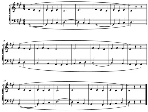

The idea that the piece is in ternary form comprising three eight-measure phrases is correct. It just needs to be taken further.
First, note that if one counts from the anacruses to the notes ending their respective phrases, one gets precisely eight bars (i.e., 24 beats). This is one way of reconciling the phrase structure with the bar lines.
Most important, it to notice the internal structure of the phrases. Each has two four-measure halves: the first half creates a sense of irresolution, and the second half, resolution. Each of these halves can be (conceptually) broken down into two two-measure sections: a quarter-note "moving" section, and a dotted half-note "calm" section.
This structure is illustrated below for the first phrase. The two green dotted-half notes added as a second voice at the end of the phrase are there to illustrate the conceptual presence of those found in the prior "calm" section.
"A" section structure (2x2)x(2x2)
The "B" phrase can easily be seen to have this same form.
"Proof"
Since the core question is the presence of an "extra" measure of rest at the end of the piece, let's focus on the ends of each phrase. To do this, let's eliminate the anacruses so that phrase endings aren't confused by overlap with phrase beginnings. In this way, every phrase ends with an "extra" measure of rest. The first phrase is shown below.
First phrase without anacrusis of second phrase
Again, this can easily be replicated for the second phrase.
Now we see that each phrase ends with an "extra" measure of rest. So try playing the piece with those extra measure eliminated. The musical result will clearly be unbalanced — a feeling that the "next" phrase arrives too early. The "extra" measure of rest is necessary to preserve the sense of metrical balance Bartók composed into the piece.
Recomposition with seven-measure phrases
