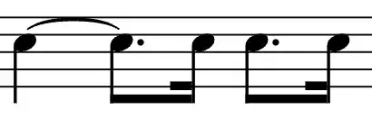

Sorry if this is a really basic question but I'm really confused about the difference between 3/4 and 6/8 and was hoping to get some explanation about this bar in particular:
quarter note tied to dotted eighth–sixteenth pair, then dotted eighth-sixteenth
This bar can be read both as 3 quarter notes or 6 eighth notes, so I'm not sure whether it is in 3/4 or 6/8.
Appreciate any help, thanks!
Aaron

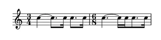

From the notation alone we can already see that this is at least thought to be 3/4 by the composer. Even more in 3/4 the rhythmic distrubution is quite uncomplex. If we were to take this as 6/8 this would become much more complicated, as you can see here:
I’d say the 6/8 one would be quite hard to perform ...

Simply put: 3/4 is three quarter-note beats and 6/8 is two dotted quarter-note beats. ...Leaving aside the variety of exceptions....
The way to know (presume) this bar is 3/4 is the way the beams are placed. They clearly delineate three beats. Were the bar intended as 6/8, it would be written as a dotted quarter-note tied to a sixteenth note. That sixteenth note would be beamed to a sixteenth note, an eighth note tied to another sixteenth, and a final sixteenth, as shown below. Note how the beaming divides the bar into 2 halves.
6/8 reinterpretation of OP rhythm

Sometimes taking one bar in isolation isn't enough to decide what the time signature is (or should be - take 'America').
However, as a basic premise, the fundamental difference is the feel. 6/8 is duple time, so can be counted both as a six time, or a slower two. And will be written as such, to help the reader. So, the bar can be seen to be split into two equal halves, each containing three quavers. 3/4 time will be written in values equal to three separate parts - three crotchets, so there won't be a sectioning into two halves.
Since this example is obviously split into three separate crotchet parts, so to speak, then it will come under the 3/4 time signature 'ruling' rather than 6/8, which it certainly doesn't align to.
