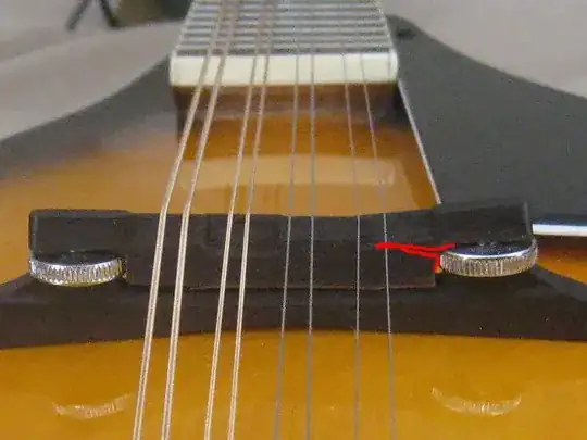

I didn't realize the bridge was a "floating" bridge, meaning it can be adjusted higher/lower with the screws. Could this be a simple matter of adjusting the bridge? I'm a little afraid to do so because I don't know which way to turn it. Also, there's a slight crack in the bridge right next to the screw: (I wonder if this is an indication that it's been "over-adjusted" before, leading to the intonation problems. That's just my guess though.)
There's a slight crack in the bridge, right next to the screw.
Here's a closer shot of the crack in the bridge (I've also highlighted it):
A closer shot of the crack in the bridge.

There are at least two things wrong in how your mandolin is calibrated, according to your excellent and helpful photographs.
  • Your wooden bridge saddle needs to be replaced because it is cracked in half, between the first and second pairs of strings. You can clearly see that the bridge saddle has collapsed and caved in, downward toward the top of the mandolin, where the wood has broken.

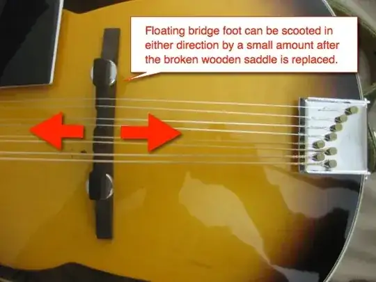

  • Your bridge is in the wrong horizontal position on the axis between the fingerboard and the tailpiece. It should probably be moved closer to the fingerboard. However, this is not going to help until the broken bridge saddle is replaced.

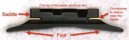

By the way, you do not understand what the term "floating" means in this case. This does not refer to the bridge's saddle being able to be raised or lowered vertically using the thumbscrews. The term "floating" means that the foot of the bridge is not glued to the top of the mandolin. The entire bridge is only held in its current position by the tension of the strings. The entire bridge can be repositioned by scooting the foot of the bridge horizontally, closer to the fingerboard or closer to the tailpiece, or even slanted slightly, to put it in the correct position for proper intonation on all four pairs of strings.

  • Thanks for the great response. I was definitely confused about the floating bridge. I've added another photo that shows a closeup of the crack in the bridge. I don't think there is actually a crack between the first and second sets of strings like you said - it is coming in from the right, and it looks to me like that screw has been adjusted so it is much too high. Please check again and tell me if this changes anything in your response. – Big McLargeHuge Oct 13 '13 at 03:06
    @davidkennedy85 Even if the crack doesn't look like it would affect some of the strings, it introduces a variable that you can't reliably correct for until it is fixed. If the bridge was already intact, the fix would be to temporarily loosen all of the strings so that the bridge could be moved forward or backward (not up or down) to correct the intonation problem. – NReilingh Oct 13 '13 at 04:32
Following on from Wheat's superb answer, I'd initially use epoxy resin and a few hours in a vice to fix your bridge. This will obviate the need to replace - the existing one has the correct profile to fit the mandolin body. Upon re-fitting, make sure the intonation is good by checking open strings against 12th fret, both pressed down and with harmonics, sliding the bridge gently between neck and tailpiece.
