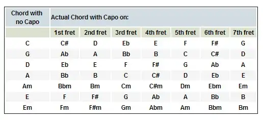

Charts such as the one below are also useful, because capos can also be used to provide different voicings to chords, giving the progression a different sound when played, which in some situations is exactly what is needed in a song.
