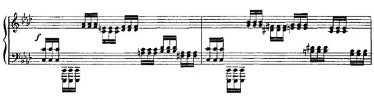

Camille Saint-Saëns's Prélude et fugue, F minor, Op. 52, No. 3 - published by Paris: Durand, n.d. Plate D. & F. 2339. Reissue (new engraving) - ca.1900
Saint-Saëns Op. 52 No. 3

I find this use of 5 or more ledger lines below the bass clef to both be less readable than ottava bassa lines and against the tendency for notes above the treble clef to use ottava alta lines instead of 5 or more ledger lines. (At least, I've found notes above the treble clef to much more commonly be found with ottava alta lines instead of 5 or more ledger lines.)

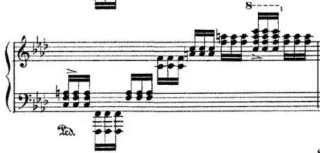

Examples of ottava alta lines for notes above the treble clef instead of 5 or more ledger lines...or even fewer ledger lines than 5 (again, all pulled from public domain scores on IMSLP):
Camille Saint-Saëns's Prélude et fugue, F minor, Op. 52, No. 3 - from the exact same score as the other excerpt from that piece:
Saint-Saëns Op. 52 No. 3 #2

Why does this double standard regarding the use of ottava lines vs. ledger lines exist? Why are notes with 5 or more ledger lines so much more common below the bass clef than above the treble clef? Why don't publishers pick exactly one, more readable standard and stick to it?

    In each of the cases cited, the left hand is in octaves. This is generally easy to see. On the other hand, the right hand parts are much more complex and varied, so having the staff available is especially helpful. – Aaron Mar 08 '21 at 06:21

    @Aaron - I've honestly found those octaves with 5 or more ledger lines to be less readable than just using ottava lines. Counting out the ledger lines and deducing notes from there has been a slight pain. – Dekkadeci Mar 08 '21 at 06:33

Let's look at your first example, the Saint-Saëns.
Yes, if there was ONLY the lowest C, it would be difficult to read and an 8vab line would help. But the higher C, on just two ledger lines, is easy to read, as is the octave interval. So we can allow the music to retain the correct 'shape' with low notes LOOKING low - this also is an important factor in readability.
The same principle applies to all your other examples. There's an 'easy' (few or no ledger lines) to give us our bearings coupled with an easily detected octave interval.
