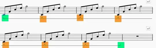

Here is my attempt to properly notate pedal sustain, based on answers above.
My problem is, MuseScore, the software I am using, does not draw sustain lines the way they seem to be needed. Using square brackets rather than sloped ones, as Dekkadeci said, the lines overlap if I include the first note of the next measure (system 1). It only works if I use sloped lines. Conversely, if I just bracket all the notes in a measure (example 2), the square lines start and end on a note, but do not encompass them (see image above). Further, if I use system 2, but the bass notes stop in the middle of the measure, the pedal sustain would not extend to the end of the measure, so the treble notes would not all be sustained. So, what the heck do I do now?

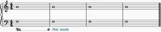

For pieces intended for beginners or students, pedal is often marked throughout. However, more conventionally, it's left to the performer. A typical way to handle this is to place pedal markings in the first measure (or two or three), and then write "Ped. sim." or "Pedal simile", which means "keep pedaling in a similar way" (see below). If you want a departure from that (say, a specific way of pedaling that's different), you would notate that explicitly at the appropriate place in the score.
Pedal marking example
Note that in the above example I've used another style of pedal indication, but, as indicated, the ones in the OP are just fine as well.

Maybe this is just more noise, but I'm going to try to clear up some of the confusion, inadvertently raised by the other answers.
So, first of all, let's separate this into 2 problems:
  • what's the proper way notation wise?
  • What's the proper way in musescore?
==Notation wise==
There's 2 types of notation:
  1. using "Ped. *"
  2. using lines
Some prefer one, others prefer the other. No matter, you should never mix them. For the purpose of the examples here, I will.
The system (2.) using the lines, will use both sloped and straight corners. They have different meanings.
-- So let's look at situation a) here --
a.1 and a.2 seem to be identical in meaning and the way they're pedalled, but they might not:
a.1 is ambiguous. You can either release the pedal at the end of the measure and re-press at the beginning of the next. -or- you can play legato, keep the pedal pressed until the first note of the next measure and then quickly pump. It's left to the player to decide what's appropriate.
a.2 is NOT ambiguous: at the end of the measure the pedal is release and re-pressed at the beginning of the next and there will be a clear, audible gap. Most of the times, this is NOT what you want. If you want to achieve legato, this is not it.
For a.2 we're using straight, 90° corners here. That's the only valid option. No slopes. The straight corners indicate "press pedal" and "release pedal" respectively. Nothing more, nothing less.
-- Ok, so let's look at situation b) then --
b.1 is identical to a.1, since there's no way to make things more clear using this notation.
b.2 however is different: it starts with a straight corner and uses the sloped ones on the first note of the next measure. This tells the player unambiguously they need to keep the pedal pressed until the note of the next measure starts and then pump quickly.
So what's with those corners? You only use the sloped ones to indicate a pump. That's it.
Proper notation:
Anything else is improper notation: starting with a sloped line, having 2 straight corners on one note etc.
Conclusion:
Use whatever notation system you want, but "ped. *" is ambiguous and the lines are not, and you should never mix both.
== Musescore ==
All of the above sound almost identical in musescore. (Not quite though, a.2 and b.2 sound slightly different to my ears) if you want more control you'll need to start editing it in a DAW where you can decide exactly where the pedal will be pressed and released.

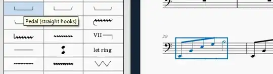

Now, in order to use notation a.2, simply select the measure and click on this specific button:
If however you wish to use b.2, you need to select the entire measure and the first note of the next one, then click the appropriate button out of 3:
Hope this clears things up.

I disagree with Aaron's answer - only System 1 shows the correct approach if you want to sustain all notes in each measure. System 2 greatly risks the human player lifting the pedal early in the last beat (e.g. Beat 4.5) and therefore breaking sustain early.
(Both systems are technically written incorrectly, as pedal lines should start and end with square, perpendicular corners a la |_ and _|, not sloped lines.)
The Ped.-and-* notation for pedalling pretty much forces you to write like System 2 even if your intent is System 1, but I hate that notation and never use it myself for exactly that reason.
To my knowledge, Musescore will play back the pedalling in both systems similarly to the human I mention in my first paragraph, so play it safe and use System 1's pedal notation instead.
The preferred pedalling notation I use, and the one I recall seeing in all my beginner piano books, is the one implied to be marked "invisible" in the last picture of Aaron's answer - start with |_, mark pedal pumps with _^__, then end with _|.

  • I cannot create the kind of Pedal marks that Aaron suggests in MuseScore. In Aaron's last example, his pedal pump occurs just prior to the notes in each measure. That is fine, because the first note of each measure should not be rung before the pedal is released. It should be rung after pedal release so that its tone can be part of the next measure. Yet in MuseScore, when you add a pedal sustain line, it either ends at the end of the last note in a measure, or ends after the 1st note of the next measure. See my two original examples. How do I create Aaron's last example in MuseScore? – fsgregs Feb 14 '21 at 03:31
  • @fsgregs - You're looking at the wrong line of Aaron's last example. Look at the faded pedal line instead. To create a pedal pump, take a pedal line ending with _ / and make that end reach the first note of the next measure, then take a pedal line starting with \_ and start it at that first note you ended the _ / at. Basically, do your original System 1 except you start it with |_ and end it with _|, keeping the middle and all its correct pedal pumps the same. – Dekkadeci Feb 14 '21 at 15:47
  • Thanks for the advice. My problem is that when I carry a pedal sustain through a measure to encompass the 1st note of the next measure as I did in my system 1 example, the synth in MuseScore will sustain all the notes in the first measure, + the first note of the next measure. That next measure, however, may change the chord or key, so including it in the prior measure will cause dissonance. In Aaron's example, his hidden pedal sustain ends in the next measure, but BEFORE THE 1st note of the next measure is played. That works with the synth but I don't know how to do that in MuseScore. – fsgregs Feb 15 '21 at 17:19
  • @fsgregs - That is actually how a human-performed version of my preferred pedalling notation works too. When lifting the pedal just at the first note of that next measure, you hear the ghosts of the previous measure. I think this is a sound you need to get used to and I've heard so often when playing from books that I don't notice it. (On the other hand, since your preferred pedalling is not what I was taught by piano teachers, I'm probably not quite used to the slightly-cut-off sound of that.) – Dekkadeci Feb 16 '21 at 13:36
The two notations command two quite different things. 1. indicates an overall legato, with a pedal 'change' on the first note of each bar. Think a phrase mark over the entire passage. This is normal 'legato pedalling'.
  1. asks for a break at each barline. Think a separate phrase mark over each individual bar.
Yes, a 'change' should be an upward V within an otherwise continuous line. 'Up and finished with pedal' is a vertical hook.
MuseScore has four pedal line shapes that can build any of them.
