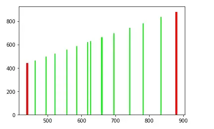

The combination of Information from the comments made it much clearer. I actually used this method to calculate the resulting frequencies starting with 440Hz and you can see quite nicely how two frequencies (618.05Hz and 626.48Hz) are really close to each other and "mess up" the otherwise almost equal distribution.
Plot of Pythagorean scale
Joe
  • 41
  • Neat! I guess the key point was to see that you need to alternate up and down around the base note. – Tom Feb 10 '21 at 17:01
