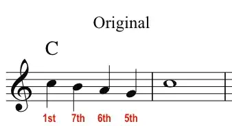

Others have given good answers already. (1) There are seven letter names in a scale and each one can be either natural, sharp, or flat. (2) Chord names are aliases for stacks of thirds. But I'll add a practical "test" you can try, to get an intuitive grasp on what's happening with the C7.
Let's say you have this melody line that's played over a C major chord. The melody has the notes: C - B - A - G - C., meaning, 1st, 7th, 6th, 5th, 1st scale degree.
Original melody
original melody
Now you want to create a variation of that melody line so that it fits over a C7 chord - what do you do? Compare these alternative melody lines:
(alt. 1) C - B - A# - G - C
melody modified for C7 wrong
(alt. 2) C - Bb - A - G - C
melody modified for C7 right
If you play these, it should be immediately obvious that alternative 2 is the correct one, and it reveals the fact that the C7 chord makes the scale's B note flat. It does not make the A sharp.
When you say "A#", it means that your A is sharp. Your 6th scale degree is sharp. By adding the title you say something about your A. It's like saying "Mr. A" or "Mrs. A". You have one "A" slot in the 7-degree scale, and it can be only sharp or natural or flat, but only one of those at any given time.
(The general "wrongness" of alternative 1 can be debated, but if the idea is to modify the original C - B - A - G - C to suit changing the chord to C7, I'd say that alternative 2 can fairly well be called the correct one.)

  • This is confusing. The wrong example should show C A# A G as per the original question. Then it becomes obvious that the visual flow of the melody's direction of travel is more easily conveyed in the second example. However, the melody line and the chords assigned are separate things. – melkisadek Dec 24 '20 at 11:16
  • @melkisadek There is no "C A# A G". Your A can be either sharp or natural but not both at the same time. I'm trying to explicate what the scale is. The sixth scale degree is A something, and it cannot be A and A# at the same time. I'm trying to say: if you say "A#", it means that you want your sixth scale degree to be sharp. Which is what was done in the Wrong example. The first note from left is the 1st scale degree. The second note from the left is the 7th scale degree. The third note from the left is the 6th scale degree. The fourth note from the left is the 5th scale degree. – piiperi Reinstate Monica Dec 24 '20 at 12:39
  • @melkisadek If you say "C A# A G", it means that between A# and A, the sixth scale degree is changed from sharp to natural. Do you understand this? And that even during the A# note, it should be possible to use the seventh scale degree B. Try playing C, B and A# simultaneously, does it sound good? – piiperi Reinstate Monica Dec 24 '20 at 15:13
  • The question asks why you write a Bb and not an A# in a C7 chord: (C E G Bb) as opposed to (C E G A#). If I press an A# on a keyboard and then press a Bb I can hit the same key. The question is why do we decide to call it Bb in this case (C7). The answer is that the chord name requires the flattened 7th from a root C which is Bb. The question asks why can't the Bb just be marked as an A#. There is nothing in your example which explains why it can't be a sharp 6 in the case of a C7 chord where there is no implied A natural. – melkisadek Dec 27 '20 at 01:42
  • @melkisadek My answer is trying to lead into thinking about what the notes of the scale are. What is the 1st note, what is 2nd note, ... what is the 6th note and what is the 7th note. That's why I added the numbers there. A is the sixth note name in the scale, B is the seventh. My examples show what it would mean if the 6th is sharp, vs. what if the 7th is flat. – piiperi Reinstate Monica Dec 27 '20 at 11:38
