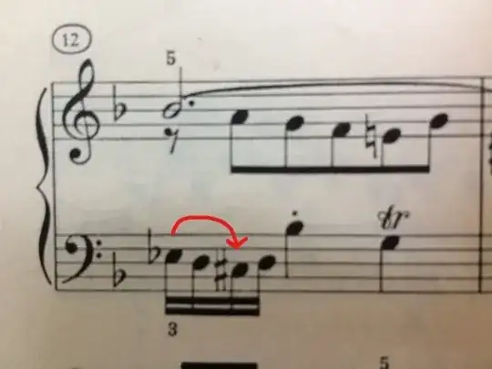

Bach's Fugue in D minor (BWV 851) from WTC I contains a diminished third in m. 12.3
Fugue in D minor m. 124 Fugue in D minor m. 12

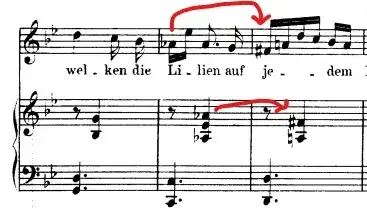

In Brahms's German Requiem, a diminished third (one of many diminished and augmented intervals in the piece) can be found in the Alto part at m. 72.5
Ein Deutsches Requiem m. 72, vocal parts6
German Requiem, m. 72
Note that were Brahms resolving to Gb Major rather than F major, he would have written the Alto B as a Cb; i.e., a minor third with the tenor.

3Adapted from https://www.teoria.com/en/articles/2017/BWV851/01.php
4J.S. Bach, Das Wohltemperierte Klavier, Teil I Urtext (1997, Henle), p. 28.
5Adapted from Ouida Clemons, "TYPICAL ELEMENTS OF BRAHMS'S CHORAL STYLE AS FOUND IN THE GERMAN REQUIEM", M.A. Thesis, North Texas State Teachers College (1942). See PDF page 52.
6Mandyczewski edition from IMSLP.
