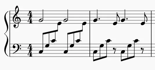

I'm writing a fairly simple piano piece which has a repeated pattern which crosses staves/hands. I think it looks clearer musically to write it with cross-staff beaming as in the first bar below, but I suspect that others, particularly those less confident reading music, might prefer the staves to be written separately as in the second bar. enter image description here
Are there any rules/guidelines for the use of cross-staff beaming? I guess it's partly a matter of opinion, but I do want it to be as clear as possible for a wide range of readers, and as it's a fairly easy piece I don't want to put off less experienced players. If anyone can point me to any hard and fast rules, or something from a grade syllabus, that'd be great. I don't recall being taught about cross-staff beaming myself, but I think it might have confused me as a beginner.

The notation helps you to see to which voices the notes belong to.
The first measure clearly suggest there are two voices, the top one moving in half-notes and the bottom one playing eight-note arpeggios.
In the second measure you have dotted rhythm melody in right hand and arpeggios consisting of three notes in the left hand. Notice that even the note lengths are different (is the first G in the violin clef supposed to be a half note, or dotted quarter-note?) That's quite different music, isn't it?

  • I had to make it a half note for the example to stop musescore showing the rest (you can hide rests for export but it still shows as greyed-out on screen). It should be dotted-quarter really. – Bob says reinstate Monica Sep 09 '20 at 22:58
    @BobsaysreinstateMonica: Even if the upper note is changed to a dotted-quarter in both versions, still a good player would play the two slightly differently, using the articulation and dynamics to make the E sound either like part of the figuration voice with the arpeggio below, or else part of a melody with the G above. – PLL Sep 10 '20 at 13:23
    @Bob Musescore is actually giving you the answer. – Andrew Leach Sep 10 '20 at 19:45
  • @AndrewLeach how do you mean? – Bob says reinstate Monica Sep 11 '20 at 13:10
  • @Bob Musescore wouldn't allow you to do what you wanted to do. Therefore what you wanted to do was at best unconventional. – Andrew Leach Sep 11 '20 at 13:45

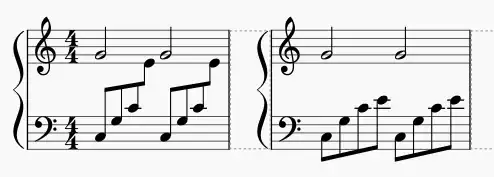

I think the two alternatives to consider are...
...cross staff versus ledger lines.
I think using ledger lines is the modern way to do it.

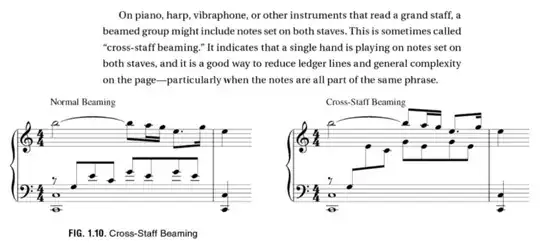

It seems to me that cross staff beaming is found in older scores. This beaming...
...also seems to be an old practice.
Personally, I like those old methods, but it's probably better to follow the modern practice.
EDIT
It seems unclear in the posts on this question how to regard the hands in cross staff beaming. My understanding is the same as this quote from Berklee Contemporary Music Notation, although I didn't learn it from that particular book...
...cross staff beaming is used to make clear phrasing and using a single hand.
Also, it seem worth noting that textbook example uses cross beam to avoid three ledger lines. The OP would avoid only two ledger lines.

These two do not sound the same. The E in the left hand (first example) sounds against the RH G; in the second example, the E stands alone (like a piece of cheese).
Whether one uses cross-staff beaming as in the first example or just writ it with two ledger notes doesn't much matter I slightly prefer the ledger lines above the bass clef as it keeps the RH voicing pattern visually separate. The second example places the E as part of the RH pattern.

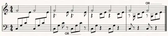

Some standard ways to write the same thing: (The "OR"s are just alternative beamings.) enter image description here I agree with you, Bob: the first bar, which was your original, looks clearest. It's odd how, without any expression marks or slurs, bars one and four look the most legato and bar two the least. In fact it looks choppy. Bar three seems to emphasize four beats to the bar, while the other bars sound as if they could be in 2/2.

    I think you are missing an important alternative which is putting the E4 in the bass using two ledger lines. – Michael Curtis Sep 10 '20 at 14:07
  • @Michael Curtis It wouldn't be played by the left hand without a reason. It could be an exercise (as someone has suggested). Or it could be that the right hand is about to play higher up the keyboard or the left hand is changing its position in preparation for what comes next. BUT as the right hand doesn't move higher, and the left hand doesn't change position - they simply repeat the figure - there is no reason to put that E on a ledger line. – Old Brixtonian Sep 10 '20 at 14:24
  • I'm confused by your point about the hands. The cross staff beaming seems to me to mean the figure is played all left hand. The other three look like one voice LH and two voices RH. – Michael Curtis Sep 10 '20 at 14:36
  • e’ in lower stave on ledger lines would have been my answer too. – Albrecht Hügli Sep 10 '20 at 15:45
