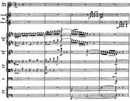

Example 1: Reading as a conductor
Here's a typical, uncomplicated example of the demand made on a conductor. There are three different clefs to be scanned. (The excerpt is from Tchaikovsky's Sixth Symphony and begins in the first movement, seven bars after rehearsal A in the linked score.)
Multiple clefs example
Note that the treble-clef instruments are notated in different keys, because of the instruments involved. So not only does a conductor need to clef-switch, but must also transpose within a clef.

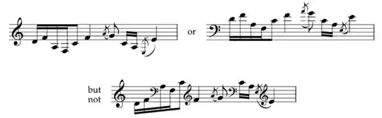

As noted, this piece is an exercise designed to help students learn to switch between clefs with ease. For "real" music, here's what Elaine Gould has to say in "Behind Bars" (a common reference for music notation):
For performance material, stay in one clef for as long as is practicable, using up to at least three ledger lines rather than changing clef frequently. This shows the contour of the pitches, which a change of clef would obscure.
This said, it is not always "practicable" to stay in a single clef. Clef changes are most frequently found in parts written for instruments in the alto to tenor range. Among orchestral instruments this includes viola, cello, trombone, bassoon, and occasionally French horn.
