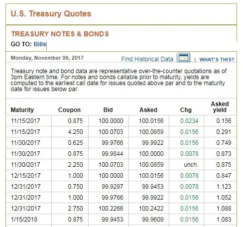

Image showing stock statistics
I am trying to understand how they calculated "asked yield". If anyone can explain it, I really appreciate it. I would like to see the mathematical formula and the calculation.

    The answer from @rhaskett is generally correct, but WSJ messes up the quote which is in 1/32nd, not decimals. You can look here for a complete replication of YTM. – AKdemy Feb 10 '23 at 14:04

  • Ok. I tried that method and it didn't give me the stated "asked yield". I solved following equation . 100.0156(1+j)^k=100+(0.875*9/365), where k=9/365. The "j" I get is not what stated here. The method we used here is "semi-practical" method to get accrued coupon. Maybe WSJ using another method. – Vajira Nov 07 '17 at 12:23
  • Hmmm... I am unable to reproduce the results exactly myself. I am doing at least two things wrong above. The price you actually pay P is the "dirty price" including accrued interest up to that point for the 182-9 days since the last payment (183? how does the government divide 365 by 2 exactly?). Rather than the "clean price" which is quoted. – rhaskett Nov 07 '17 at 16:19
  • The second thing is I'm not correctly taking into account the the accrual method (and calendar!). Note on the 4th line the ask price is exactly 100, but the ask yield is not equal to the coupon. So there are some details on that side I'm missing. Maybe a holiday calendar? – rhaskett Nov 07 '17 at 16:25
  • I'm happy to remove my answer so you can hopefully get a more complete one. I was unable to find documentation into the details here. You might have more luck on quant.SE. – rhaskett Nov 07 '17 at 16:30
  • Yes, I forgot to add accrued interest. Assuming coupon paid every six months, (for first entry)last time coupon paid is May 15,2017. Form there to Nov 15, 2017 we have 184 days(actual). If the bond sold at asked price, then buyer has to pay Asked price+Accrued interest Nov 06 and he will get $100 and coupon amount at Nov 15. From last coupon date(May 15) to Nov 06, there are 175 days(actual). So the accrued interest is (0.875/2)(175/184)=0.4161. So he has to pay 100.0156+0.4161=100.4317. He will get 100+(0.875/2) Nov 15. Still I do not get the stated yield – Vajira Nov 07 '17 at 18:03
