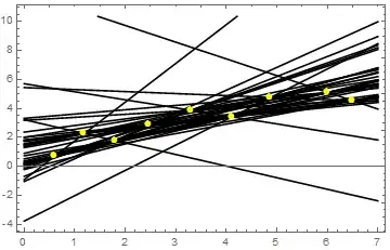

Find all the two-point combinations and calculate lines. Find which lines have no points above it, then choose which one you want: the steepest, the shallowest or the one closest to the gradient of the line of best fit.
Here's a demo, coded in Mathematica.
pts = {
{0.605187, 0.70719}, {1.1902, 2.27393}, {1.79539, 1.78899},
{2.48127, 2.87079}, {3.30836, 3.87798}, {4.11527, 3.43034},
{4.88184, 4.77326}, {6.01153, 5.10899}, {6.49568, 4.54944}};
pairs = Subsets[pts, {2}];
Print[Length[pairs], " pairs of points"]
36 pairs of points
Clear[x]
line[{{x1_, y1_}, {x2_, y2_}}] := Module[{},
m = (y2 - y1)/(x2 - x1);
b = y1 - (m x1);
m x + b]
linefunctions = Map[line, pairs];
(* plot all lines passing through all the pairs of points *)
Show[Plot[linefunctions, {x, 0, 7}, PlotStyle -> Black],
ListPlot[pts, PlotMarkers -> Automatic, PlotStyle -> Yellow], Frame -> True]

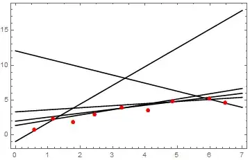

(* initialise list *)
savedlines = {};
check[line_, pair_] := Module[{},
(* exclude pair from test points *)
testpoints = Complement[pts, pair];
(* calculate projected y for test points *)
projectedy = ReplaceAll[line, x -> Map[First, testpoints]];
(* if projected y is greater or equal to test points' y save line *)
If[Union@Thread[projectedy >= Map[Last, testpoints]] == {True},
AppendTo[savedlines, line], Nothing]]
MapThread[check, {linefunctions, pairs}];
Show[Plot[savedlines, {x, 0, 7}, PlotStyle -> Black],
ListPlot[pts, PlotMarkers -> Automatic, PlotStyle -> Red], Frame -> True]
So, several lines meeting your criterion to choose from.
