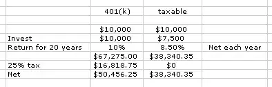

Let's pull out a spreadsheet -
We start with $10,000, and assume the 25% bracket. This gives a choice of $10,000 in the 401(k) or $7500 in the taxable account. Next, let 20 years pass, with 10% return each year. The 401(k) sees the full 10% and after 20 years, $67K. The taxable account owner waits to get the 15% cap gain rate and adjusts portfolio, thus seeing an 8.5% return each year and carrying no ongoing gains. After 20 years of 8.5% returns, he has $38K net. The 401(k) owner on withdrawal pays the 25% tax and has $50K, still more than 25% more money that the taxable account. Because transactions within the account were all tax deferred.
EDIT - With respect to davmp's comment, I'll offer the other extreme -
In his comment, he (rightly) objected that I chose to trade every year, although I did assign the long term 15% cap gain rate, he felt the annual trade was my attempt to game the analysis. Above, I offer his extreme case, a 10% return each year, no trade, no dividend. Just a cap gain at the end. The 401(k) still wins. I also left the tax (on the 401(k)) at withdrawal at 25%, when in fact, much, if not all will be taxed at 15% or lower, which would put the net at $57K or 30% above the taxable account final withdrawal.
The next issue I'd bring up is that the 401(k) is taken out at the top (marginal) tax rate, e.g. a single filer with taxable income over $37,650 (in 2016) would save 25% on that 401(k) deduction. Of course if the deduction pulls you under that line, I'd go Roth or taxable. But, withdrawals start at zero. Today, a single retiree has a standard deduction ($4050) and exemption ($6300) for a total $10,350 "zero bracket" with the next $9275 taxed at 10%. This points to needing $500K in pre tax accounts before withdrawals each year would get you past the 10% bracket. (This comes from the suggestion of using 4% as an annual withdrawal rate).
Last - the tax discussion has 2 major points in time, deposit and withdrawal, of course. But, the answers here all ignore all the time in between.
In between, you see that for any number of reasons, you'll drop from the 25% bracket to 15% that year. That's the time to convert a bit of money to Roth and 'top off' the 15% bracket. It can happen due to job loss, marriage with new spouse either not working or having lower income, new baby, house purchase, etc.
Or in-between, a disability put you out of work. That permits you to take money out with no penalty, and little chance of paying even the 25% that you paid going in. This, from personal experience with a family member, funded a 401(k) with 28% money. Then divorced and disabled, able to take the $10K/yr to supplement worker's comp (non taxed) income.

  • You mentioned the match, but ran the numbers without it. – Xalorous Aug 30 '16 at 19:39
  • Multiply the 401(k) column by the match impact. If $18k was 6% of OPs income, the match would literally double that column. When I looked at our last statements, 1/3 of our balance was due to company match. Including this in the spreadsheet would add a layer of complexity and would actually require knowing the percent that actually got matched. The mention of the match was meant to be anecdotal since no one else mentioned it – JTP - Apologise to Monica Aug 30 '16 at 19:43
    Sorry, but I don't buy your speadsheet. There is no reason that a taxable account has to suffer a 1.5% earning penalty every year of 20 years. For example, I could pick a basket of individual growth stocks and get no divi and hold for 20 years. At the same 10% return, this would get me $50,456.25 in portfolio value at the end of the 20 years -- same as the 401k. Agree that I would pay cap gains on that, but I'm not limited by any gov't limitations to how much I can put away so while the 401k could only start with 18,000 I could put more than that in the taxable. – davmp Aug 31 '16 at 00:18
  • No problem. The assumptions I make are clear. One can use any set of assumptions they wish, including a single purchase buy and hold, with one sale at withdrawal time. Better still, the taxable account can assume a zero cap gain and stepped up basis on death of the owner, the 401(k) can't do that. – JTP - Apologise to Monica Aug 31 '16 at 01:25
  • @davmp - I added a snapshot to reflect your scenario. Let me know if I misrepresented your position. – JTP - Apologise to Monica Aug 31 '16 at 14:24
  • @JoeTaxpayer - you did a fine summary. Thanks for the update! Regarding the ability to put more into a taxable, it's obvious to me the next day that you'd put the full 18k into the 401k and THEN put the extra into a taxable. Get the matching and higher return on the 18k, plus the extra growth from the amount in the taxable. – davmp Aug 31 '16 at 22:49
  • @davmp - If someone is putting $400/check into their 401(k) they see $300 less net pay, the $100 "saved" is sitting in the 401(k), it's not like they have the $100 to then invest outside the account. Unless I misunderstood your last comment. – JTP - Apologise to Monica Sep 01 '16 at 12:27
  • @JoeTaxpayer - You totally misunderstood my comment. I was self-addressing my earlier comment about being limited to 18k contribution in the 401k. Let me try to re-phrase what I was trying to point out: If I make enough to save more than the contribution limit for a 401k, I should still put the 18k in the 401k (the left side of your sheet) and then add any extra to the taxable brokerage (the right side of your sheet), rather than putting all of it in the taxable brokerage (the right side of your sheet). Said another way, the contribution limit isn't a reason to avoid a 401k. – davmp Sep 02 '16 at 12:38
  • yes, "Regarding the ability to put more into a taxable" must have confused me. My mistake. – JTP - Apologise to Monica Sep 02 '16 at 13:17

  • Retirement savings (by way of 401k) is a way to defer paying taxes now, when your tax rate is higher than when you retire, theoretically. You give up liquidity for a, theoretically, lower tax rate.
    Also, 100% yearly compounded at X% ROR and then pay 20% is far better than 80% yearly compounded at the same ROR. The longer the compounding period, the more dramatic the difference. It is exponentially better (quite literally).
    – Xalorous Aug 30 '16 at 19:51
  • To clarify, two reasons the 401k is better than after tax investing. One is that the retirement savings contribution is also a deduction lowering your taxable income. The other, and this one is the one that seals the deal, is the employer matching. – Xalorous Aug 30 '16 at 19:57
  • Welcome to Money.SE, it can be a tough crowd at times, strong opinions and love of facts. There is no 20% bracket. Ideally one might choose Roth when paying 15% tax and traditional pretax to avoid 25%. That balance is as close to a generalized ideal solution as one can articulate in a sentence. – JTP - Apologise to Monica Aug 30 '16 at 20:09
  • @Xalorous I understand that the 20% rate would not apply every year. However, you can't assume that you will never have a realizable event for your investments. Even if you plan on putting money into non-dividend paying stocks and holding for 30 years, even one sale and movement to a different stock at year 15 will significantly accelerate the recognition of tax, thereby reducing the amount of principle to which compounding growth can be applied. – Grade 'Eh' Bacon Aug 30 '16 at 20:17
  • My point is to show the principle - the actual math will of course be more complex. While you would say 'this is a worst-case scenario', imagine a country with 50% marginal tax rate. 20% looks quite low, to my eyes... – Grade 'Eh' Bacon Aug 30 '16 at 20:18
  • I'm sorry, but I am actually right on this. Multiplying is commutative.
    If you have 1000 and in 19 years you get 10% interest and in one year you take a 20% loss, then it doesn't matter in which year that 20% loss happens the end result is the same. There are 20 different places that 20% loss can fall and numerically there is no difference no matter which year it's in. I am also not going to assume I am talking about tax advantaged vs not tax advantaged. The assumption we are going to use is my assumption which is the one where you pay tax either up front or at the end.
    – Raiddinn Aug 03 '18 at 20:28
