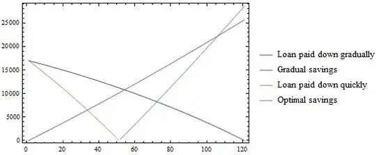

The chart below compares paying down the loan and saving equally (the gradual scenario), versus paying down the loan quickly at 2 x $193 and then saving 2 x $193. The savings rate, for illustration, is 2%.
Paying quickly pays down the loan completely by month 51. On the other hand, in the gradual scheme the loan can't be paid down (with the savings) until month 54, which then leaves 3 months less for saving. In conclusion, it's better to pay down the higher rate loan first. Practically speaking, it may be useful to have some savings available.

    +1 for the graph and clear numerical analysis. And for the "some savings" remark. – JTP - Apologise to Monica Mar 04 '15 at 15:14
  • Am I reading this graph correctly that we're looking at $26k in gradual savings and $29.5 in optimal savings? Aka this savings account is costing OP about $3500 over 10 years (or roughly 30 extra bucks a month)? – corsiKa Mar 04 '15 at 19:14
  • Hi, Yes, that sounds right. There's quite a big difference between the 6.8% loan rate and the 2% savings rate. – Chris Degnen Mar 04 '15 at 19:28
  • The two saving schemes are approximately Σ 193*(1 + 0.00165)^(k - 1) for (k = 1 to 120) = 25588.70 compared to Σ 2*193*(1 + 0.00165)^(k - 1) for (k = 1 to 120 - 51) = 28184.80. The second calc should also include some change at the start, left over from finishing paying down the loan. – Chris Degnen Mar 04 '15 at 19:52
