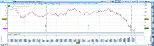

I plotted a chart comparing the last 3 years of USO and CL futures (click here for a full-sized version of the chart):
There are 2 lines on the chart - the purple line represents USO and the green/red line represents the CL futures. As you can see, they pretty much move in tandem with each other. So for USO to reach $30, the CL futures will need to reach about $82.

That graph above is misleading and incorrect. I do not know how it was created, but USO suffers from contango and backwardation. It does NOT follow WTI that closely.
WTI is usually in contango and USO loses value near the first of a month when USO rolls the futures contract to the next month. Usually done the 6 - 10 th approx.
This article explains and shows how contango affects USO.
http://seekingalpha.com/article/189214-how-contango-can-kill-commodity-etf-returns
