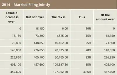

Let me go one more step, and explain what I think Joe meant in his comment below - tax table first -
At retirement, say a couple has exactly $168,850 of income. With the $20K in standard deduction and exemptions, they are right at the top of the 25% bracket. And have a federal tax bill of $28,925. Overall, an effective rate of 17%.
Of course this is a blend from 0%-25%, and I maintain that if some money could have gone in post tax while in the 10%/15% brackets, that would be great, but in the end, if it all skims off at 25%, and comes out at an effective 17%, that's not too bad.
