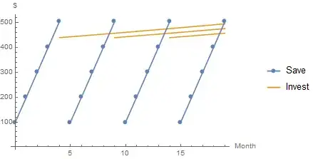

With a cycle length n = 5 amounts before investing, a schematic looks like so:-
Each investment amount at five month intervals is $439.09, shown by example calculations.
100 (1 + r)^4 + 100 (1 + r)^3 + 100 (1 + r)^2 + 100 (1 + r) + 100 - 65 = 439.09
n = 5
a = x[n - 1] = 504.09
z[0] = 439.09
The schematic shows the investments extending only over 19 months.

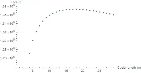

Extending for 600 months smooths out the curve giving a clear optimum of n = 18. Same n for 6000 months; the curve is now static (although the totals change). Recalculation can be made for different interest rates, periodic amount and brokerage fee.
As mentioned though, producing a formula for the optimal n is not so easy.

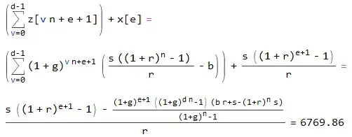

An expression for the total at each n can be obtained, e.g. with
max = 60
n   = 5
d   = Quotient[max, n] = 12   (the integer quotient of max and n)
e   = Mod[max, n] = 0
(s ((1 + r)^(e + 1) - 1) -
   ((1 + g)^(e + 1) ((1 + g)^(d n) - 1) (b r + s - (1 + r)^n s))/
    ((1 + g)^n - 1))/r = 6769.86

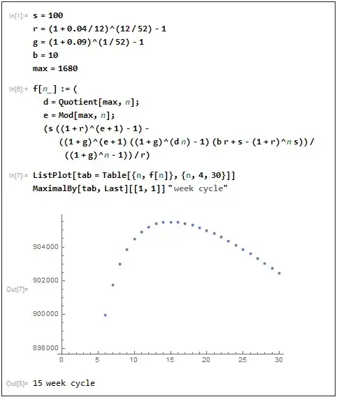

Applying this to the OP's demo question
For example, I might put aside $100 every week to invest into a stock with an expected growth of 9% p.a., but brokerage fees are $10/trade. For how many weeks should I accumulate the $100 before investing, if I can put it in my high-interest bank account at 4% p.a. until then?
Taking the bank rate as nominal compounded monthly and the stock rate as effective.
The amount invested upon accumulation of each 15 amounts is
((1 + r)^14 + (1 + r)^13 + (1 + r)^12 +
 (1 + r)^11 + (1 + r)^10 + (1 + r)^9 +
 (1 + r)^8  + (1 + r)^7  + (1 + r)^6 +
 (1 + r)^5  + (1 + r)^4  + (1 + r)^3 +
 (1 + r)^2  + (1 + r) + 1) s - b = 1498.09
