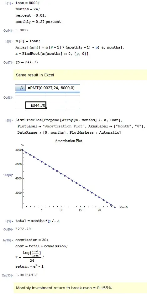

Here are my re-run figures. Not counting capital gains taxes, I calculate you need to be making 1.875% per annum or 0.155% per month on your $8,000 investment to break-even on the loan. It's interesting that the return you need to gain to break-even is less than the interest you're paying, even with commission. It happens because the investment is gaining a return on an increasing amount while the load is accruing interest on a decreasing amount.
Ref. r, logarithmic return

  • Thanks a lot. Upvote. 1. Possible error – 0.30%8000 = 0.00308000 is the monthly interest that's constant every month. But the In[1] code shows annual = 0.30. Is this right? –  Nov 12 '13 at 04:36
  • Also, can you please add the Mathematica code to your answer (NOT as a comment)?
  • –  Nov 12 '13 at 04:36
  • I have added a rerun with 0.27% monthly and $8000 principle. – Chris Degnen Nov 12 '13 at 09:39
    @ChrisDegnen - I am still struggling with the idea that a lower return investment can pay off the higher rate loan. There has to be something else happening, an influx of cash? That's why the investment isn't dropping, but the loan is? – JTP - Apologise to Monica Nov 12 '13 at 17:55
  • Yes, the loan is being paid down, so the higher rate has less impact. If the investment is good the loan provides leverage to buy in more. That's the basic principle of leverage. – Chris Degnen Nov 12 '13 at 20:21
