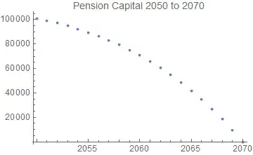

If the £3000 annual annuity is based on today's value, and you expect to retire in 30 years, £100k would last about 20 years according to my calculation based on my answer here.
The main difference is due to the inflation-linked withdrawals starting at ~£6300. (If they actually start at £3000 I calculate the drawdown period could last 57 years.)

The first inflation-linked withdrawal is w (1 + i)^30 = £6292.70
and the pension pot is drawn down to zero in March 2070.

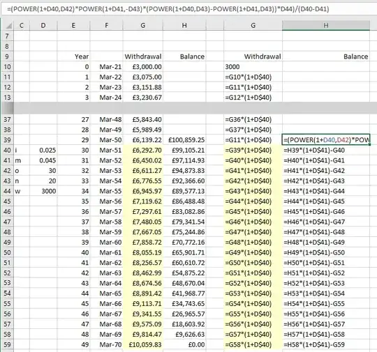

Calculation in Excel
Here is the same calculation illustrated in Excel. The 20 withdrawals are highlighted yellow.
