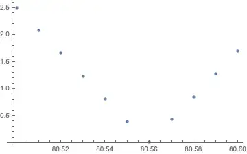

Trying out an iterative approach.
Starting with initial balance of $2500.
s  = 2500
r1 = 8/100/12
r2 = 18/100/12
q  = 1500
n = 36
The following function sets p to s, then iterates p = Min[p, q] (1 + r1) + Max[p - q, 0] (1 + r2) - d for n months. Finally the absolute value of p is returned.
f[d_] := Module[{p = s},
  Do[p = Min[p, q] (1 + r1) + Max[p - q, 0] (1 + r2) - d, {n}];
  Abs[p]]
The aim is to find a value of d that minimises Abs[p].
Plotting values f for d ranging from 80.5 to 80.6
ListPlot[Table[{x, f[x]}, {x, 80.5, 80.6, 0.01}]]
A value of d = 80.56 brings the balance of the 3 year loan close to zero.
So payments for 3 years: $80.56, for 4 years: $63.38 and for 5 years: $53.19

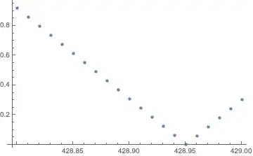

Checking with a reduced example: repay in 6 months
n = 6
ListPlot[Table[{x, f[x]}, {x, 428.8, 429, 0.01}]]
d = 428.95
Calculating the balance month-by-month to check.
1500.00 (1 + r1) + 1000.00 (1 + r2) - d = 2096.05
1500.00 (1 + r1) +  596.05 (1 + r2) - d = 1686.04
1500.00 (1 + r1) +  186.04 (1 + r2) - d = 1269.88
1269.88 (1 + r1) +    0.00 (1 + r2) - d =  849.40
 849.40 (1 + r1) +    0.00 (1 + r2) - d =  426.11
 426.11 (1 + r1) +    0.00 (1 + r2) - d =    0.00
The loan balance is reduced to zero in six months. The method checks out.

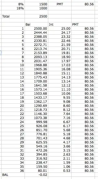

If you are comfortable with spreadsheets, this is the way to go -
The interest cell shows
=IF(F16>1500,10+(F16-1500)*0.015,F16*0.08/12)
It seemed to me the "trick" is to calculate the interest for each period, and this is the way to do it automatically. I used an initial loan of $2500, in cell F16. The interest is simply one of 2 choices. If the balance is over 1500, it equals $10 (one month out of $120/yr at 8%) plus 1-1/2% of the excess. If less than $1500, it's just .08/12.
The full sheet for 36 months -
It took just a few guesses to get to the nearest dollar, an $80 monthly payment. A few more gusses, and you'd have the answer to the nearest cent, $80.56
Note, edited to correct typo. My answer now agrees with Chris'. Same result, a bit different method.
