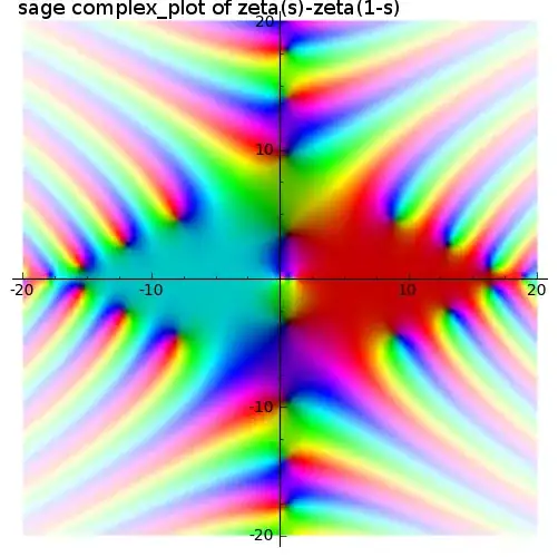

The starting value was opportunistically chosen from this plot. The colors are explained here

  • What exactly is being plotted? – Gerry Myerson Feb 26 '12 at 11:42
  • @Gerry just added a legend to the plot (may need to reload). This is sage complex_plot of $\zeta(s)-\zeta(1-s)$. – joro Feb 26 '12 at 12:04
  • Why does large Re(s) slow the computation? Note that you don't need to calculate the zeta function, the question is really about the gamma function (cf. my response). – GH from MO Feb 26 '12 at 16:41
  • I just proved that there are no nonreal solutions with $|\Re s|$ sufficiently large. See "EDIT 2" in my response. – GH from MO Feb 26 '12 at 18:00
  • Sorry, I still don't know what's being plotted. What do the different colors mean? – Gerry Myerson Feb 26 '12 at 22:12
  • Gerry thank you, my mistake. Added link in the answer to the colors: http://www.sagemath.org/doc/reference/sage/plot/complex_plot.html. Basically: plots output of the function over the specified xrange and yrange as demonstrated below. The magnitude of the output is indicated by the brightness (with zero being black and infinity being white) while the argument is represented by the hue (with red being positive real, and increasing through orange, yellow, ... as the argument increases). – joro Feb 27 '12 at 10:21

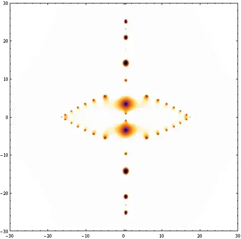

Here are two images to complement joro's image.
Zeroes of $ \zeta(s)^2 - \zeta(1-s)^2 $:
Zeroes of $\left ( 2^s \pi^{s−1} \sin \left ( \frac{\pi s}{2} \right ) \Gamma (1-s) \right ) ^2 - 1$:
In particular it seems to be the case that all zeroes inside the critical strip are on the critical line, and that all other zeroes don't stray too far from the origin, as hinted at by GH's answer.
