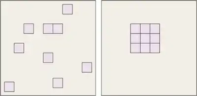

There are $N=n^2$ "bots" on distinct integer lattice points in the plane. Each knows the positions $p_i$ of all bots, and each has unlimited (private) memory. Each executes the same algorithm $\cal{A}$: at time $t=0,1,2,\ldots$, bot $i = (t \bmod N)$ executes $\cal{A}$, which (possibly) examines the bot positions and consults its memory, resulting in it either remaining at $p_i$, or moving 1 unit in one of the four compass directions to an unoccupied lattice point.
Q1. Is there an algorithm $\cal{A}$ which, starting from an arbitrary configuration of $N$ bots, terminates with all bots arranged in an $n \times n$ square?
          Bot Party
          (This question is inspired by (but not mentioned in) arXiv:1111.2259.)
I believe the answer to Q1 is Yes, say by gathering toward the lowerleftmost bot, but I don't see it in clear detail. If this is right, then suppose omniscience is blocked by opacity:
Q2. Is there an algorithm as before, but now with each bot $p_i$ knowing the position of $p_j$ only if the line segment $p_i p_j$ does not share a point interior to a unit square centered on any other $p_k$.
My guess here is: No.
