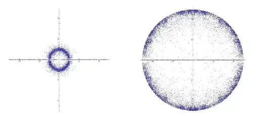

Two graphs
Notice that the roots of the first graph cluster around the unit circle, as explained above. However, the roots of the second graph are clustering around the boundary. Indeed, this turns out to reflect reality (see the theorem below).
