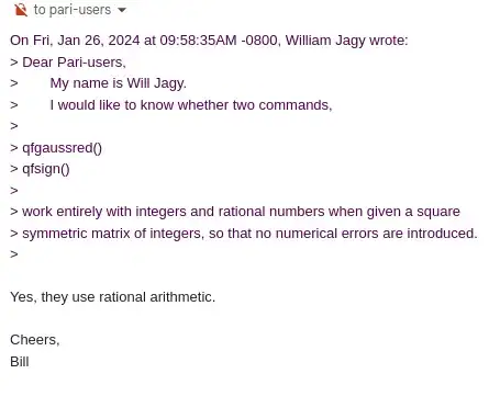

  • Got a reply from Pari-gp. Both the commands qfgaussred() and qfsign() run on rational numbers when given a square symmetric integer matrix. So, as in the idea of @BrendanMcKay, run qfsign() on $A, A+I, A-I,$ and compare – Will Jagy Jan 26 '24 at 19:02

  • Suggest you also subscribe to their users mailing list \\\\\\ Date: Fri, Jan 26, 2024 at 9:38 AM \\\\\\\\\\ Subject: subscribe \\\\\\
    To: pari-users-request@pari.math.u-bordeaux.fr \\\\\\\\\\\
    Not sure how this works. \\\\\\\\\\\\\
    Will Jagy \\\\\\\\\\\
    – Will Jagy Feb 06 '24 at 17:31

YES, the pari/gp function called qfsign() does use rational numbers only!!!!! You may use it and not fear!
Got a reply from Bill Allombert himself, on a mailing list
Pari-gp has a version of what I did, naming it after Gauss rather than Lagrange, in the French manner. It is quick, just field operations, so all are rational numbers if you give it integers.

    The command "qfsign" from Pari/GP computes the signature of the quadratic form associated with the matrix - I have never dared to use it because I do not know if it uses exact arithmetic, and I have been bitten too many times by numerical instability. But your answer here suggests that it is possible to do this in rational arithmetic - do you know if Pari/GP actually does this? – Gordon Royle Jan 25 '24 at 07:53
    @GordonRoyle yes, both qfsign() and qfgaussred() use exact arithmetic, integer and rational numbers – Will Jagy Jan 26 '24 at 20:53
