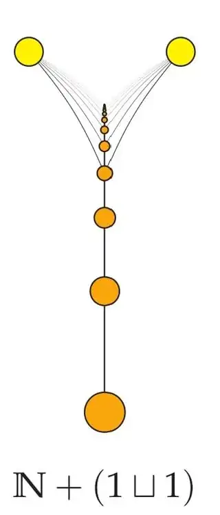

Let me begin by observing that every application of Zorn is equivalently made with an order not having the LUB property.
Duplication orders. Take any partial $\mathbb{P}$ and consider the duplication order $\mathbb{P}^*$, in which every element has been duplicated, replaced with two or more clones that are incomparable to each other but ordered with respect to the other elements according to the original order. Every chain in $\mathbb{P}^*$ has an upper bound, if this was true for $\mathbb{P}$, but now there are no least upper bounds for chains not having a largest element, since any of the clones works equally well. The duplication construction is often used for various purposes in mathematics, and this example shows furthermore that every application of Zorn's lemma can be turned into an example of the requested incomplete phenomenon.
