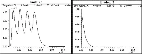

  1. Suppose this is a observed sampled signal with 256 points (left, Window 1). We also know what distorted it by linear convolution. Its length was 256 points.
What people do is that they do a 256 point DFT on the observed signal. DFT is also performed on the distorted function, 256 points.
a) Divide the DFT(observed signal)/DFT(distorting function);

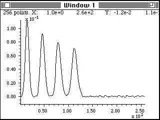

b) Take the inverse DFT, we get

  • May be I was not clear. Let me add a graphical version in the original question. A picture is worth a thousand words. – AChem Jan 15 '21 at 15:08
  • Then, according to the picture, your distortion kernel has length approximately 60 (right-padded with zeroes), the original signal has approximately 130 points (right-padded with zeroes, up to numerical artifacts), and the distorted signal has length roughly 185 (right-padded with zeroes). This agrees with what I wrote above, does it not? – Mateusz Kwaśnicki Jan 15 '21 at 15:59
  • @MateuszKwaśnicki, Right, your number analysis agrees with the n+k-1 requirement. However, if we assume that the original data had 130 points, then this will create experimental problems. For example, this implies that one collected the data up to 130 s (one point per second) rather than 256 seconds. In reality the signal was collected to for 256 s. In practice, I can tell you that people really do not care about this requirement n+k-1, but I am wondering why. They take the length of the distorting kernel same as the experimental signal, divide their DFTs and do an inverse. – AChem Jan 15 '21 at 16:12
