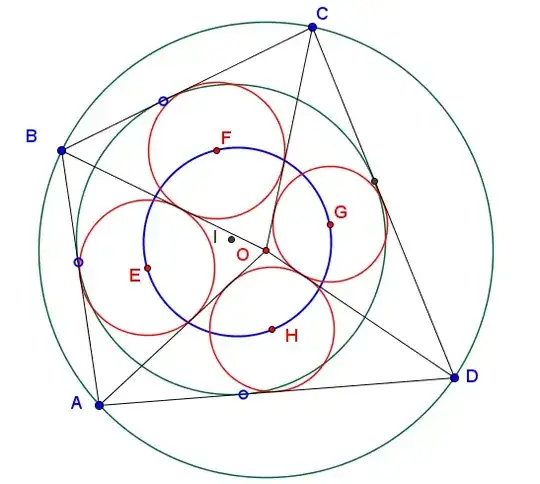

Let $ABCD$ be a bicentric quadrilateral, $O$ is center of circle $(ABCD)$. Then Incenter of four triangles $OAB,OBC,OCD,ODA$ lie on a circle.
My question: Could You give a your solution for problem above.

Without loss of generality assume that $O=(0,0)$ and the ABCD circle has radius 1. Then $$\begin{cases} A=(\cos \alpha,\sin\alpha),\\ B = (\cos\beta,\sin\beta),\\ C = (\cos\gamma,\sin\gamma),\\ D = (\cos\delta,\sin\delta),\\ AB = 2\sin\frac{\alpha-\beta}2,\\ BC = 2\sin\frac{\beta-\gamma}2,\\ CD = 2\sin\frac{\gamma-\delta}2,\\ AD = 2\sin\frac{\alpha-\delta}2,\\ \end{cases} $$ where we assume $2\pi\geq \alpha\geq \beta\geq \gamma\geq\delta\geq 0$, and by Pitot theorem: $$(\star)\qquad\sin\frac{\alpha-\beta}2 + \sin\frac{\gamma-\delta}2 = \sin\frac{\beta-\gamma}2 + \sin\frac{\alpha-\delta}2.$$
For the incircles coordinates we have $$\begin{cases} E = \tan(\frac{\pi}4-\frac{\alpha-\beta}4)\left(\cos\frac{\alpha+\beta}2,\sin\frac{\alpha+\beta}2 \right),\\ F = \tan(\frac{\pi}4-\frac{\beta-\gamma}4)\left(\cos\frac{\beta+\gamma}2,\sin\frac{\beta+\gamma}2 \right),\\ G = \tan(\frac{\pi}4-\frac{\gamma-\delta}4)\left(\cos\frac{\gamma+\delta}2,\sin\frac{\gamma+\delta}2 \right),\\ H = \tan(\frac{\pi}4-\frac{\alpha-\delta}4)\left(\cos\frac{\delta+\alpha}2,\sin\frac{\delta+\alpha}2 \right) \end{cases} $$
The points $E,F,G,H$ are concyclic iff $$\det \begin{bmatrix} OE^2 & E_x & E_y & 1\\ OF^2 & F_x & F_y & 1\\ OG^2 & G_x & G_y & 1\\ OH^2 & H_x & H_y & 1 \end{bmatrix} = 0. $$ In our case it takes the form: $$\det \begin{bmatrix} \tan(\frac{\pi}4-\frac{\alpha-\beta}4) & \cos\frac{\alpha+\beta}2 & \sin\frac{\alpha+\beta}2 & \cot(\frac{\pi}4-\frac{\alpha-\beta}4)\\ \tan(\frac{\pi}4-\frac{\beta-\gamma}4) & \cos\frac{\beta+\gamma}2 & \sin\frac{\beta+\gamma}2 & \cot(\frac{\pi}4-\frac{\beta-\alpha}4)\\ \tan(\frac{\pi}4-\frac{\gamma-\delta}4) & \cos\frac{\gamma+\delta}2 & \sin\frac{\gamma+\delta}2 & \cot(\frac{\pi}4-\frac{\gamma-\delta}4)\\ \tan(\frac{\pi}4-\frac{\alpha-\delta}4) & \cos\frac{\delta+\alpha}2 & \sin\frac{\delta+\alpha}2 & \cot(\frac{\pi}4-\frac{\alpha-\delta}4) \end{bmatrix} = 0, $$ which can be verified routinely under the condition $(\star)$.
To verify the identity we can express everything in terms of $X:=e^{I\frac{\alpha-\beta}2}$, $Y:=e^{I\frac{\beta-\gamma}2}$, $Z:=e^{I\frac{\gamma-\delta}2}$, and $T:=e^{I\frac{\delta}2}$. In particular, we have $\sin\frac{\alpha-\beta}2 = \frac{X-X^{-1}}{2I}$, $\tan(\frac{\pi}4-\frac{\alpha-\beta}4) = \frac{(X-I)I}{X+I}$, $\cos\frac{\alpha+\beta}2 = \frac{X(YZT)^2 + X^{-1}(YZT)^{-2}}2$, and so on.
The following SageMath code verifies that the determinant as a rational function over variables $X,Y,Z,T$ reduces to $0$ w.r.t. the polynomial ideal defined by $(\star)$:

The code prints "0" (run it online), thus establishing the determinant identity.
