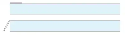

    I think this should work. Consider 2 rectangles with r1 having dimensions 1x11 and r2 having area 10x100. Then the packings that have aligned sides have enclosing areas at least 1100, but if you "lean" r1 against the end of r2 then you can get an enclosing rectangle with area around 1025. – Yosemite Stan Apr 27 '19 at 19:06

          RectTilted
          @YosemiteStan's example.
          Detail: Tilt angle $=\sin ^{-1}\left(5 \sqrt{\frac{2}{61}}\right) \approx 65^\circ$.

    Actually, in the first packing the smaller rectangle should lie on the top of the larger one, giving the intended area of 11*100=1100. – Victor Protsak Apr 27 '19 at 19:51
  • @VictorProtsak: Thanks; corrected. – Joseph O'Rourke Apr 27 '19 at 19:55
  • The first packing is $100\cdot (10+1) = 1100$, but I think the second packing is $\left( \frac{10}{61}(11+6\sqrt{22})+100 \right)\cdot 10\approx 1064.2$, so the example is valid, but $1025$ from the original comment is not so precise. To me, it is hard to estimate visually by staring at the figure, which packing is better, but I can see that the "leaning" thin box is more upright than $45^\circ$. – Jeppe Stig Nielsen Apr 29 '19 at 10:07
  • @JeppeStigNielsen: "more upright": Yes, about $65^\circ$. See added detail. – Joseph O'Rourke Apr 29 '19 at 11:52
    @JeppeStigNielsen: You can increase the length from $100$ to an arbitrarily large length, in which case it is clear that the bottom picture covers less area. – Tony Huynh Apr 29 '19 at 12:43
