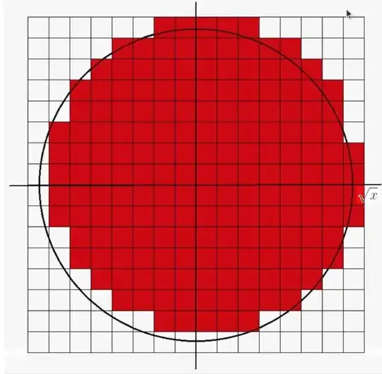

The heuristics for this problem is due to Gauss: the error term $\delta N(R)=N(R)-\pi R^2$ must scale with the circumference $2\pi R$ of the circle, because it is along the circumference that the ambiguity of lattice points just inside or just outside the circle appears; Gauss' estimate $\delta N(R)\propto R$ is an overestimate, the configuration of lattice points is such that the excess and deficit of points just inside and just outside partially cancels each other, so that the exponent is closer to $1/2$. Intuitively, this cancellation is obvious from a figure, but to obtain the correct exponent is not something that I think is accessible by any heuristics.
UPDATE: This could be an intuitive argument ("heuristics") for $\delta N(R)\propto R^{1/2}$: The number $M$ of lattice points along the perimeter is of order $R$. If each lattice point contributes $\pm 1$ to $\delta N(R)$, and these $M$ contributions are statistically independent, the total contribution would be of order $\sqrt M\propto\sqrt R$.
Source: The Circle Problem of Gauss and the Divisor Problem of Dirichlet—Still Unsolved.
Each lattice point is associated with a unit cell, chosen such that the lattice point is in the lower-left corner of the cell. Lattice points inside the circle correspond to a cell shown in red. The number of red cells that extends outside the circle cancels approximately with the number of white cells that extend inside, producing a sub-linear scaling of $\delta N$ with the radius $R$ of the circle.
