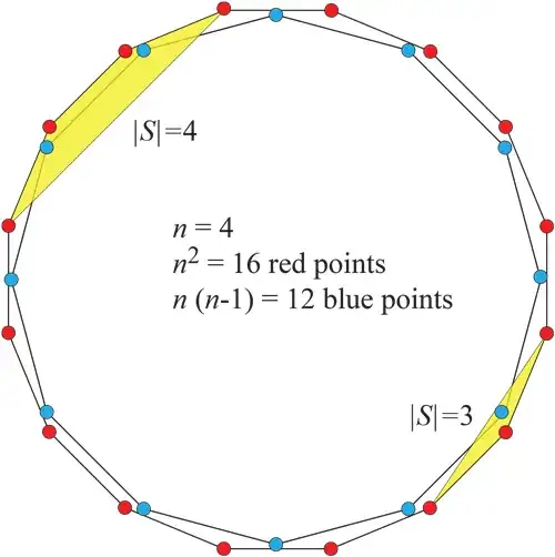

Consider the $n^2$ red points at the vertices of a regular $n^2$-gon, and the blue points at the vertices of an inscribed regular $n(n-1)$-gon, suitably rotated. It seems this is one of the situations that needs careful analysis.
          RedBlue
