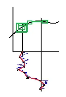

I know this thread is already two years old, but, while preparing for a path integration exam, I arrived at an intuitive picture that sheds some light on the origin of the extra term. The picture represents an integral of a smooth function with respect to a concrete realization of Brownian motion. The sum of the areas of the green rectangles represents the difference between Ito (using the left point of each interval) and "anti-Ito" (using the right point of each interval) for sampling of the Brownian motion represented by the red line. Finer sampling leads to smaller rectangles, but they overlap more and more (because Brownian motion is not monotonic), so even if the area occupied by them tends to zero, the sum of their areas does not. This suggests (only suggests -- it is an upper bound on the difference, not a lower bound) that there is a "room" for Ito and "anti-Ito" to differ in their values. Stratonovich can be expected to lie somewhere in between.
Look at the following image:
https://lh6.googleusercontent.com/-bEPzm01WyGk/T-WplGQAc3I/AAAAAAAAACQ/mZr-5p0VUrw/s317/integral-wrt-brownian-motion.png
                 Brownian Motion
Joseph O'Rourke
  • 149,182
  • 34
  • 342
  • 933
    (I included the image whose URL was cited.) – Joseph O'Rourke Jun 24 '12 at 00:00
  • @Pavel: +1: Thank you, this is really interesting. Did you arrive at this picture yourself or did you see it in a paper, book etc? Then a reference would be great. Thank you again. – vonjd Jun 24 '12 at 10:04
    I arrived at it myself, so I am not aware of any reference to provide. It is certainly very heuristic. For example, some of the rectangles have actually negative sign. OTOH, if we know from a rigorous proof that the extra term is nonzero, this picture attributes that term to the fact that the the error rectangles overlap. – Pavel Bažant Jun 26 '12 at 10:00

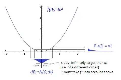

Intuition of Ito integral
Consider the stochastic process
$$f(B_t)$$
where $B_t$ is standard Brownian motion (or the Wiener process) and $f$ is a twice-differentiable function.
Ito’s lemma states that
$$df = f'(B_t) dB_t + \frac{1}{2} f''(B_t) dt$$
The first term is recognizable from the chain rule in classical calculus, but why the second term? If $dB_t$ is truly infinitesimal, it doesn’t even seem possible that $df \neq f'(B_t) dB_t$.
To understand Ito’s lemma intuitively, think of $dB_t$ as a little stochastic variable, specifying $B_t$‘s change during the next $dt$.
$$dB_t = B_t - B_{t+dt} \sim N(0,dt)$$
This models Brownian motion (or the Wiener process) completely. Now $df$ should be a little stochastic variable too, modeling the stochastic process $f(B_t)$.
The picture at the start considers an example $f(B_t)$ where $f'(B_t)=0$, thereby suppressing the “intuitive” or classical term in Ito’s lemma. The reason why $df>0$ in that picture is the reason why that “non-intuitive” term is needed.
Loosely speaking, wherever $f$ has curvature, $dB_t$ will diffuse around that curvature sufficiently to influence the expected result on the order of $dt$. (The specific example in the picture makes this trivial, as $f(\sqrt{t}) = t$.)
Why doesn’t $dB_t$ dominate away $(dB_t)^2$ (i.e. $dt$ )? Because $E[(dB_t)^2]$ does not come from $(E[dB_t])^2$ as happens with classical differentials. The strong law of large numbers implies that a stochastic differential’s expected value pushes its integral on a faster order than its deviation does.
