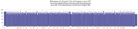

Igor and Aaron discuss the "spikes" around rational numbers. This seems related to binning: if our bins have width 1/1000, we see spikes at multiples of 1/2, 1/4, 1/5, 1/10, etc., related to divisors of 1000. Here's a new picture, which might help us understand the behavior of the distribution of $\sqrt{n}$ mod 1 near rational numbers. I've intentionally drawn the bins so that their endpoints lie on rational numbers with denominator up to 60. (I call this Farey-binning). This seems to bring the "spikes" around rational numbers down to the same size (independent of denominator).

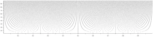

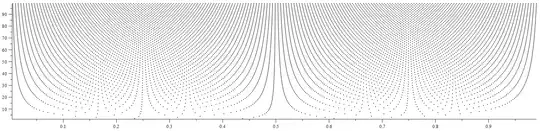

Here are some plots which might be helpful. The first is all the points $(\frac{k}{2t},t)$ for $1 \lt t \lt 100$ and $1 \leq k \leq 2t-1.$ So pretty much like a Farey plot and with a vertical column above each small denominator rational.
The second is all the points $(\frac{k}{2t}-\frac{k^2}{8t^3},t).$ This looks like the first one with a leftward tug so the vertical columns are replaced by a curve having that column as an assymptote.
The graph we care about for this question is visually indistinguishable from the second. That would be the points $(\sqrt{t^2+k}-t,t).$
Note that $$\frac{k}{2t}-\frac{k^2}{8t^3} \lt \sqrt{t^2+k} \lt \frac{k}{2t}-\frac{k^2}{8t^3}+\frac{k^3}{16t^5}.$$

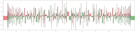

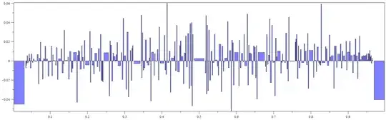

If one wants to bin to study this I would suggest taking the small denominator fractions as roughly the centers of bins. Below are two graphs illustrating this. I suggest using mediants as the bin boundaries. For example, sorting the frasctions in [0,1] with denominator up to $30$ by size, three consecutive ones are $\frac{13}{29},\frac9{20}, \frac{5}{11}.$ For the bin around $\frac{9}{20}$ I would take boundaries $\frac{13+9}{29+20}=\frac{22}{49}$ and $\frac{9+5}{20+11}=\frac{14}{31}.$ Note that the "center" $\frac9{20}$ is only about a bit more than a third of the way from the left endpoint to the right. This is because the $11$ pushes harder then the $29.$ This is one of the more extreme examples.
At any rate, the first graph below uses bins around the $277$ fractions in lowest terms $\frac{a}b$ with $1 \leq a \lt b \lt 30.$ Into the bins I put all $B=100806$ irrational fractional parts $\sqrt{t^2+k}-t$ for $1 \leq t \leq 2k$ and $1 \leq t \leq 316.$ The count $c$ is is then normalized to the ratio of $\frac{c}{B}$ to the expected value $\frac{B}{w}$ where $w$ is the width of the bin. I left a little space between bins. The maximum discrepancy is $ 0.060188$ and the average is $0.01477$
The second graph is the same thing except each bin is split at the rational it surrounds. The left part is colored red and the right part green. It seems that usually, but not always, it is as with $\frac12,$ the left half is over $1$ and the rights half under. I haven't looked into the details more closely. The variation is about three times as large. The maximum deviations for the left and right halves are $.1763188$ and $.160645$ while the average discrepancies are $0.047085$ and $0.045767.$
  • This binning issue is subtle -- very cool! I've updated the question a bit to show the effect of "Farey binning". I think this should highlight the somewhat unusual behavior of this distribution near rational numbers, without showing preference for certain denominators. – Marty Feb 03 '18 at 20:23
