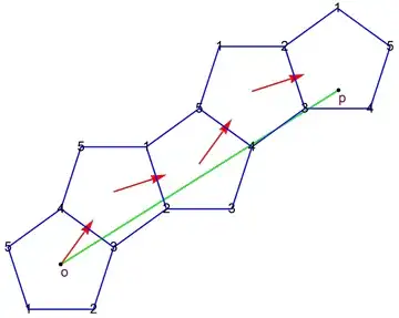

Greedily choosing, at each step, the roll that is best aligned with the vector $p-o$ does not always succeed.
Could one characterize the sequences of roll indices $s$, where rolling over edge $(i,i+1)$ of the pentagon is index $i\,$? These sequences feel analogous to continued-fraction approximations. What do all the points $p$ of $\mathbb{R}^2$ with $dd(p)=k$ look like, i.e., what is the shape of a $dd$-circle $C_k$?

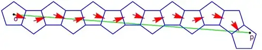

          Dodeca717
          $p=(18.3,-1.4)$, $dd(p) \le 12$, $s=(2, 4, 1, 3, 5, 2, 4, 1, 3, 5, 2, 5)$.

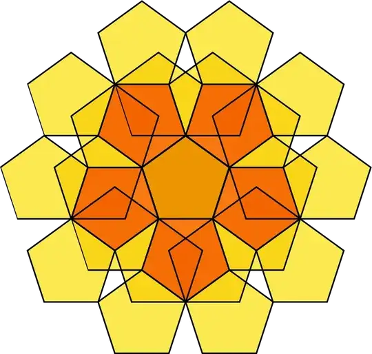

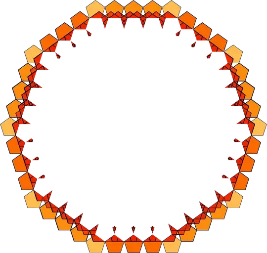

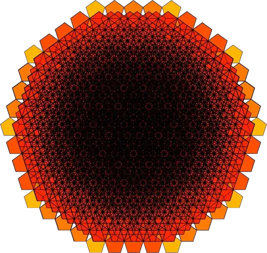

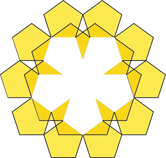

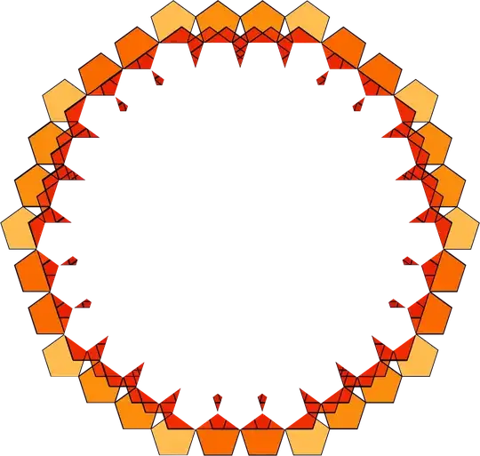

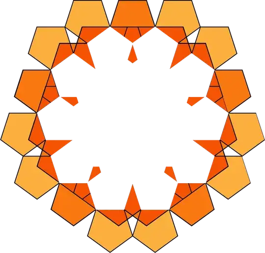

Here are pictures of $D_k$ for $k=1,\dots,8$ placed side by side with $D_{k}\setminus D_{k-1}$, (made by "hand" from edited versions of this file from wikipedia):

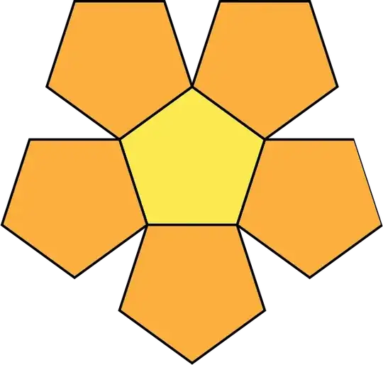

$D_1$:

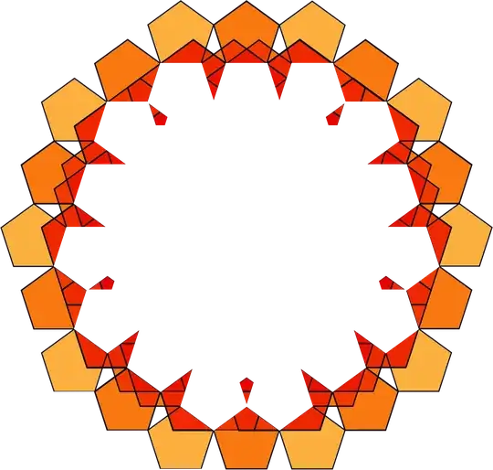

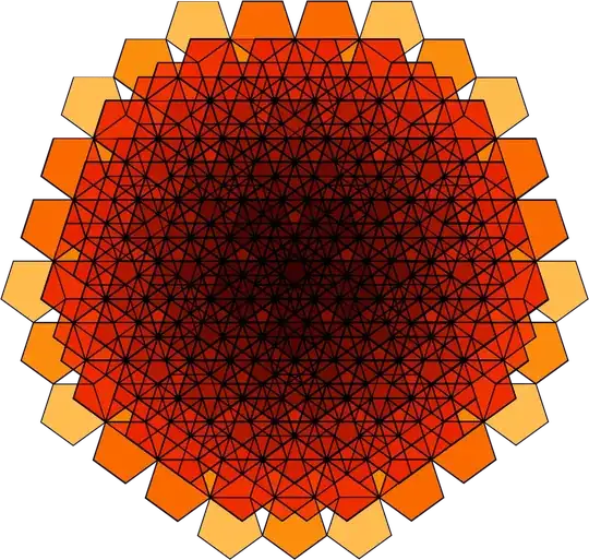

$D_2$ and $D_2\setminus D_1$:
$D_3$ and $D_3\setminus D_2$:

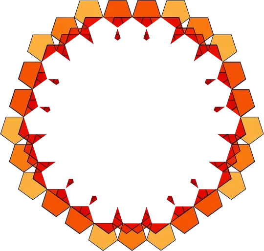

$D_4$ and $D_4\setminus D_3$:

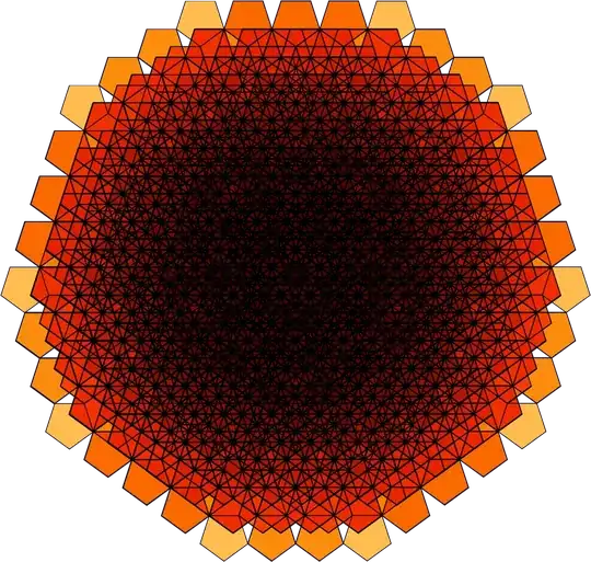

$D_5$ and $D_5\setminus D_4$:

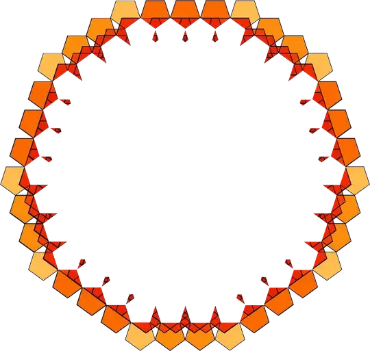

$D_6$ and $D_6\setminus D_5$:
$D_7$ and $D_7\setminus D_6$:
$D_8$ and $D_8\setminus D_7$:
From these images, the following patterns are apparent: the "outer frontier" of $C_k$ is determined by a closed chain of $5k$ pentagons joined vertex to vertex. When $k$ is odd, these pentagons are all "down-pointing" and when $k$ is even they all are "up-pointing". From now on assume $k\geq2$. Then the pentagon chain is formed from 10 "segments of pentagons", which I'll call pentasegments, joining 10 corner pentagons where the pentasegments change direction.
There are two types of pentasegments: those where the bases of the constituent pentagons point outwards relative to the interior of $D_k$ (type I):
type I pentasegment
and those where the vertices of the pentagons point outwards (type II):
type II pentasegment
The top pentasegment of $C_k$ is type I if $k$ is odd and type II if $k$ is even and the 10 pentasegments alternate between type I and type II so that there are 5 of each type.
When $k$ is even, there are $k/2-1$ pentagons on each pentasegment lying strictly between the corners (the number of pentagons on each pentasegment including the 2 corners is $k/2+1$).
When $k$ is odd, there are $(k-1)/2$ pentagons on each type I pentasegment between the corners and $(k-3)/2$ pentagons on each type II pentasegment between the corners. There are holes between each of the pentagons lying on the type II pentasegments, thus there are $5\lfloor \frac{k}{2}\rfloor$ holes in total.

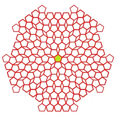

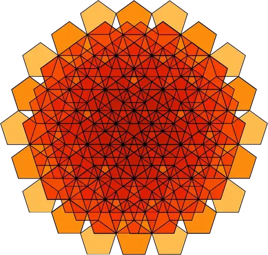

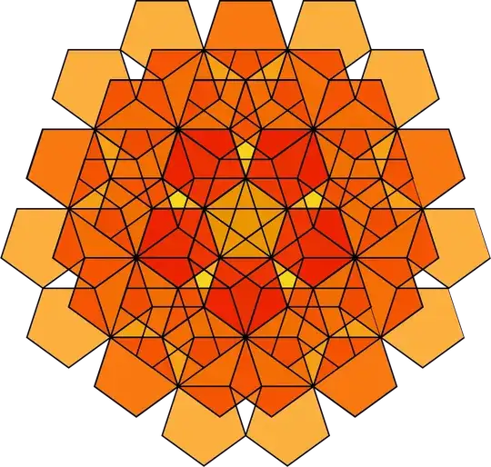

Here are a few pictures and speculations to add to the the great ones from @j.c.
Here are the pentagons which arise from starting with the central green one and doing the reflections which do not overlap any previous ones.
These are just the outer frontiers of the $C_i.$ (Specifically, this shows the frontiers for $i \le 7$ and half the frontier for $i=8$.) It seems clear (though I do not claim a proof) that for a target point inside one of the pentagons one does best to roll out to it using just these pentagons. For a target point in one of the rhombi one should roll out to a neighboring pentagon and at the last step reflect over a previously unused (for reflections) edge. One can use one of the bordering pentagons closest to the center for the closer half of the rhombus and a small part of the further half.
Here is a central portion of the same thing with lines connecting the centers of pentagons which share an edge. The resulting hexagons tile the plane with a $5$-fold rotational symmetry.
