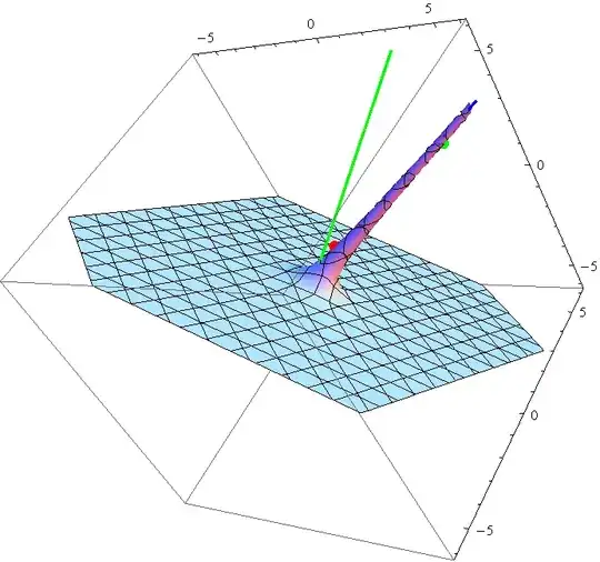

First, let's consider a pure cubic field $\mathbb{Q}(\sqrt[3]{d})$, an element $(x,y,z)^{\top} = x + d^{1/3}y + d^{2/3}z$ with norm $N((x,y,z)^{\top}) = x^3 + dy^3 + d^2z^3 - 3dxyz$ and multiplication $$ \left( \begin{array}{c} x_1 \\ y_1 \\ z_1 \end{array} \right) \cdot \left( \begin{array}{c} x_2 \\ y_2 \\ z_2 \end{array} \right) = \left( \begin{array}{c}x_1x_2 + d(y_1z_2+z_1y_2)\\ x_1y_2 + y_1x_2 + dz_1z_2 \\ x_1z_2 + y_1y_2 + z_1x_2 \end{array} \right).$$
Due to $$ \begin{aligned} & x^3 + dy^3 + d^2z^3 - 3dxyz = \\ & (x + d^{1/3}y + d^{2/3}z)(x^2 + d^{2/3}y^2 + d^{4/3}z^2 - d^{1/3}xy - d^{2/3}xz - dyz) = 1 \end{aligned} $$ one realizes that the norm-1-surface is funnel-shaped with an asymptotic plane $x + d^{1/3}y + d^{2/3}z = 0$ and the opening of the funnel showing in direction $(d^{2/3}, d^{1/3}, 1)^{\top}$. The angle between the normal of the plane and the funnel direction is $\arccos(3d^{2/3}/(1+d^{2/3}+d^{4/3})$. Cutting the surface with planes parallel to the asymptotic plane yields ellipses.
See figure https://i.stack.imgur.com/QSC0S.png
[Norm-1-surface for $d=2$ shown with $(1,1,1)$ (red) and $(1,1,1) \cdot (1,1,1) = (5,4,3)$ (green). The green line indicates the normal of the asymptotic plane, the (nearly not visible) blue line the funnel direction.]

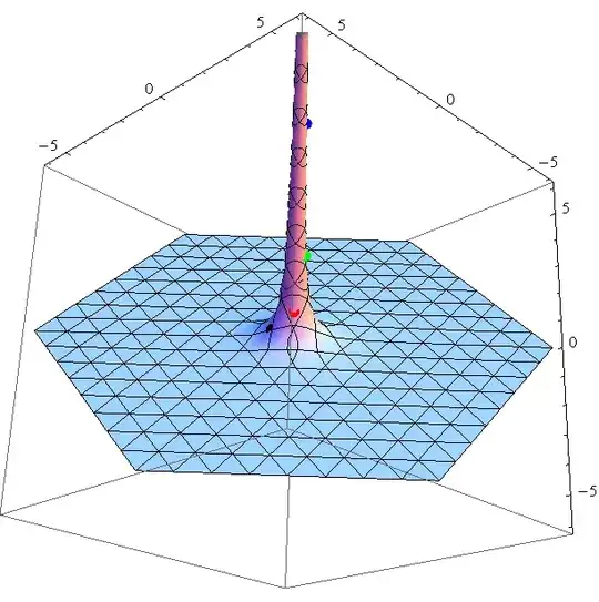

For the number field irrelevant, geometrically yet reasonable case $d=1$ the norm-1-surface gives a rotationally symmetric funnel (cf.
https://i.stack.imgur.com/mCbWR.png
[Norm-1-surface for $d=1$ shown with powers (multiples) of a point, spiraling around the funnel]) and the group multiplication is just multiplication of the height above the asymptotic plane and complex multiplication (i.e. addition of angles) in the plane perpendicular (parallel to asymptotic plane).
Interestingly this is also valid for the case of general $d$: Applying the linear transformation $$ \left( \begin{array}{c} x' \\ y' \\ z' \end{array} \right) = \left( \begin{array}{ccc} 1 & d^{1/3} & d^{2/3} \\ 1 & -\frac{1}{2}d^{1/3} & -\frac{1}{2}{d^{2/3}} \\ 0 & \frac{1}{2} \sqrt{3} d^{1/3} & -\frac{1}{2} \sqrt{3} d^{2/3} \\ \end{array} \right) \left( \begin{array}{c} x \\ y \\ z \end{array} \right) $$ gives the group multiplication law in the new coordinates as
$$ \left( \begin{array}{c} x'_1 \\ y'_1 \\ z'_1 \end{array} \right) \cdot \left( \begin{array}{c} x'_2 \\ y'_2 \\ z'_2 \end{array} \right) = \left( \begin{array}{c} x'_1x'_2 \\ y'_1y'_2 - z'_1z'_2 \\ y'_2z'_1 + y'_1z'_2 \end{array} \right),$$ i.e. a simple multiplication in $x'$-direction und complex multiplication (i.e. addition of angles and multiplication of modulus) in the $y'-z'$-plane.

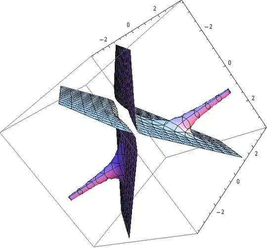

As I have it on my hand, here a 3d slice of the norm-1-surface for a pure cubic field of degree 4:
https://i.stack.imgur.com/suz3l.png
