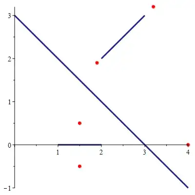

Addition. Here is a modification of Joseph picture which demonstrates the difficulties when realizing the idea by Per
If the points $A(\frac {38} {20},\frac {38} {20}) $ and $B(\frac {32} {10},\frac {32} {10} ) $ are assumed to belong to $\{(x,y):y \ge x,y\ge 3-x\} $, then the proof suggested by Per fails.

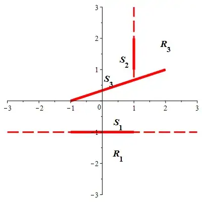

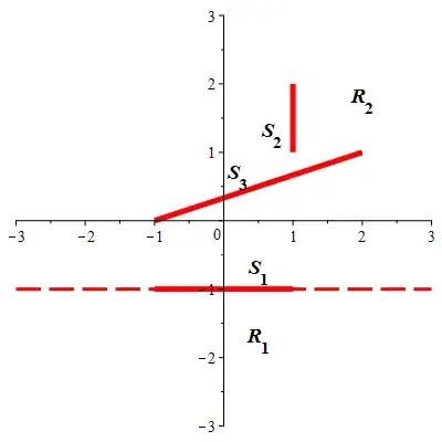

Addition 2. I'd like to demonsrate another difficulty which appears in the Per's approach. Let us consider three segments $S_1:=[(-1,-1),(1,-1)],\,S_2:=[(1,1),(1,2)],\,S_3:=[(-1,0),(2,1)]$. The points are not of importance here. After the first step the plane is divided into two regions $R_1$ and $R_2$. enter image description here
After the second step we obtain the regions $R_1$ and $R_3$, where the latter is not convex. enter image description here
It is unclear for me whether after the final step we obtain the convex regions only (the larger the value of $n$, the more complicated the situation). One more problem consists in the definitions of the borders of the regions. In order to apply the pigeonhole principle the regions considered with their borders must not intersect. My advice to Per is to read the book I. Lakatos. Proofs and Refutations. Cambridge: Cambridge University Press.(1976). https://books.google.com.ua/books/about/Proofs_and_Refutations.html?id=1n6SFdXCOBQC&redir_esc=y

  • Re "Addition 2": Per Alexandersson's proof only regards the final step. At that point, every region is bounded by line segments (or rays/lines) and, due to the construction, every point at which multiple segments intersect, one of the segments continues all the way through - thus the arrangement determine only angles less than $\pi$, so the determined regions must be convex. The issue of boundaries is not related to the pigeonhole principle (which is a purely combinatorial statement) and the boundaries are explicitly handled by Joseph O'Rourke's addition. – Milo Brandt Nov 27 '17 at 22:47

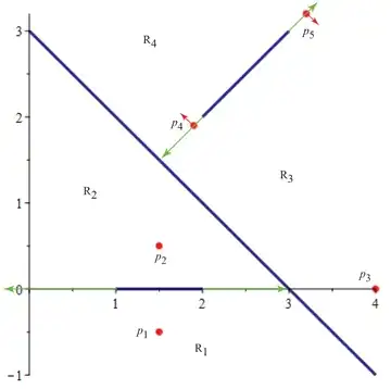

I was drawing this figure as Per Alexandersson replied and Jan-Christoph Schlage-Puchta commented, so I'll just leave it as an illustration of their idea that $n$ segments determine $\le n+1$ convex regions:

(Added later.) Below I try to illustrate the suggestion I made in a comment, repeated here: "Direct the extensions away from the segment [green below]. Assign a point on an extension to the convex region to the right of the extension. Then two points, one on the forward extension, one on the backward extension, are in two different regions and are invisible to one another." I use the OP's example:
          SegsPtsCollinear
          $p_1,p_2,p_3,p_4$ are in $R_1,R_2,R_3,R_4$ (respectively).
          $p_4$ and $p_5$ cannot see one another, but $p_5 \in R_3$, the 2nd point in $R_3$.
