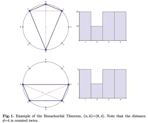

Consider $n$ evenly spaced points on a circle representing $\mathbb{Z}^n$. Two sets of points with the same multiset of distances between them (measured by the shortest distance around the circle) are said to be homometric. In the music literature, homometric point sets correspond to pitch-class sets with the same intervalic content, and this theorem is known as the "hexachordal theorem":
Hexachordal Theorem: Complementary sets with $k=n/2$ (and $n$ even) are homometric.
In particular, Schoenberg realized that two complementary chords of six notes each in a twelve-tone scale have identical intervalic content, and so have analogous "aural effects."
Homometric
Figure from: Ballinger, B., Benbernou, N., Gomez, F., O’Rourke, J., & Toussaint, G. (2009, June). The Continuous Hexachordal Theorem. In International Conference on Mathematics and Computation in Music (pp. 11-21). Springer Berlin Heidelberg.
