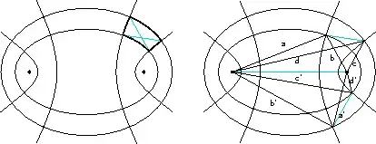

Let me give a geometric interpretation for the case of tetrahedra of volume zero. The statement becomes as follows:
Given four positive numbers $a,b,c,d$ that satisfy the quadrangle inequalities, denote $$ s=\frac{a+b+c+d}2, \quad a'=s-a \text{ etc.} $$ Take a quadrilateral with side lengths $a,b,c,d$ (in this cyclic order). If its diagonals have lengths $x,y$, then there exists a quadrilateral with side lengths $a',b',c',d'$ and the same diagonal lengths.
Again, this can be proved by a direct computation, but Arseniy Akopyan noticed that this is equivalent to the Ivory lemma: diagonals in a curvilinear quadrilateral formed by four confocal conics are equal, see the left half of the picture.
Indeed, with two opposite vertices of an $(a,b,c,d)$-quadrilateral as the foci, draw two ellipses and two hyperbolas through the other two vertices. This gives a curvilinear quadrilateral whose diagonal is also a diagonal of our $(a,b,c,d)$-quadrilateral, see the right half of the picture. The relations between $a,b,c,d$ and $a',b',c',d'$: $$ a+b=c'+d', c-d=d'-c' \text{ etc.} $$ imply that the other two vertices of this curvilinear quadrilateral form together with the foci an $(a',b',c',d')$-quadrilateral.
As a side remark: I studied configuration spaces of planar quadrilaterals in this preprint, but didn't know about Regge symmetries. Thanks to Dylan and Igor for bringing this up!
There is an analog of the Ivory lemma in dimension three, but there is no word about volumes in it. Still, it would be interesting to look at the corresponding configuration of confocal surfaces (one of the families degenerates).
Also note that the Ivory lemma holds in the hyperbolic and spherical geometry as well.
