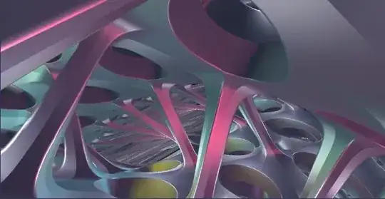

EDIT: In addition to the beautiful work of Zeno Rogue and Pierre Berger (linked to in the other answers) the reader may be interested in the visualisation efforts of Remi Coulon, Brian Day, Sabetta Matsumoto, Henry Segerman, and Steve Trettel. You can interact with seven of the eight here. Finally, here is a snap-shot of Sol geometry.
Flying through Sol geometry

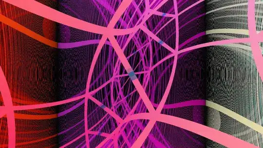

We have recently started working on visualizing Sol.
Sol is defined by the following metric in $\mathbb{R}^3$: $ds^2 = (e^zdx)^2 + (e^{-z}dy)^2 + dz^2$
I think it is quite easy to see what is going on there: there is a Z coordinate and moving along this Z coordinate makes your Y steps larger (double each $\log(2)$ moved on the Z axis) while making your X steps smaller (double each $-\log(2)$ moved). In a hyperbolic space both would expand together (that's how the half-space model works if you replace the Z coordinate by its logarithm).
enter image description here SolvView by MagmaMcFry gives a native perspective visualization of both Sol and Nil. By native perspective I mean that the view you see here is the view you would get if you were inside the space, assuming that the light travels on geodesics.
We have added Sol as a playable geometry in the current beta of HyperRogue (viewable both in the native perspective projection and in projection of the simple model above). Here is a video of a camera rotating in Solv, looking at some surfaces of constant Z.
UPDATE: we have implemented all Thurston geometries. See the release post and the geometry page.

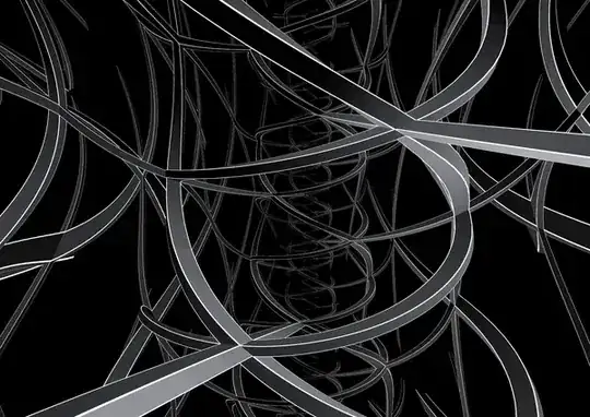

Not only could you see the eight geometries at ihp's exposition esthetopies last summer, but you could also hear them. The exposition is now over but the pictures are on the site of Pierre Berger, the author of the exposition. Here is a picture of SOL (copyright P. Berger)
SOL geometry
